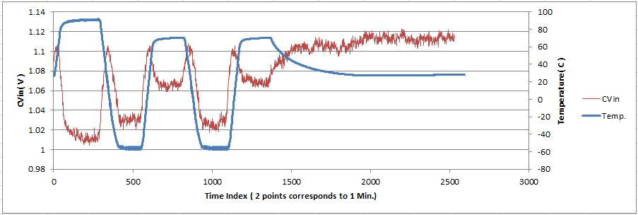

May I know more info. on thermal transient behavior of  INAs & OPAs (specifically INA331). Because in one of our amplifiers we experience higher overshoots of the output during the temperature transients of about  2 o C/Min    before it becomes stable after the transition time.

  • Thank you for your comments, Still I'm not clear. So I added more info. into the thread.

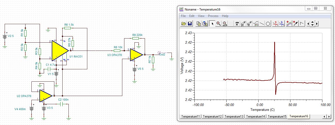

     Following is a TINA-TI simulation for the circuit I'm testing.  All resistors are 25 ppm.
    The real test data measured at the output is shown below
    As can be seen there are over shoots during temperature variations.
    Can you please comment on why we see these over shoots
    Kavindu

  • What are the axes and scale?
    -Ken

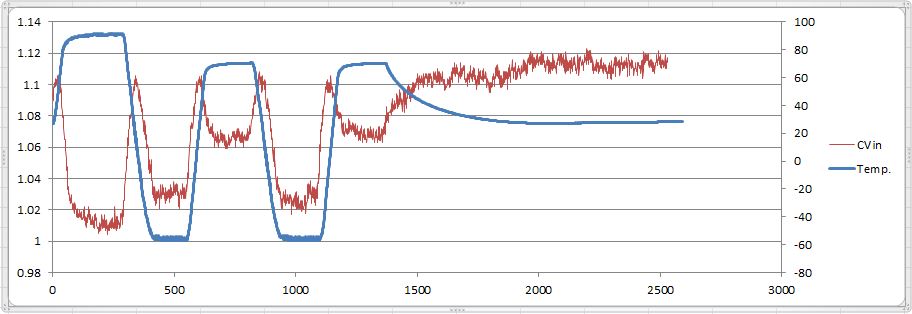

  • Ken,
    pls see the corrected plot

  • Kavindu,
    I am not clear what the CVin vertical axis on your graph show - there is no such label on your schematic (see below) and with the componets values you use there is no node with potential around ~1.06V - see below.
    Other than that, the recommended resistor values for gain of 95 you use should be R5=180k and R6=10k, G=5+5*(180k/10k)=95, and NOT 27k and 1.5k, respectively, as shown on your schematic - see below.
  • Thank you all for your attention on this regards and sorry if I'm keep on confusing you.
    Actually the CVin corresponds to the out2 of the schematic and the front end of the INA is fed by a Strain gauge bridge in real. I just put 4 resistors to represent those so that the value at the CVin  may  have different simulated values opposed  to real values depending on the bridge balance.
    Kavindu

  • Kavindu,
    You need to be much more specific about the issue - asking an open-ended question like what is the thermal transient behavior of INAs and op amps is much too broad.  In general, there should be only small variations in transient behavior as compare to room temperature BUT with this type of questions the devil is typically in details.  I previously pointed out that the INA331 recommended resistor values for gain of 95 you use in your application are R5=180k and R6=10k, G=5+5*(180k/10k)=95, and NOT 27k and 1.5k, respectively, as shown on your schematic.  Have you tried these values as the current drive of INA331 may be unable to drive 1.5k load.
    If you need further assistance, please provide detailed application schematic with actual values of components used.
