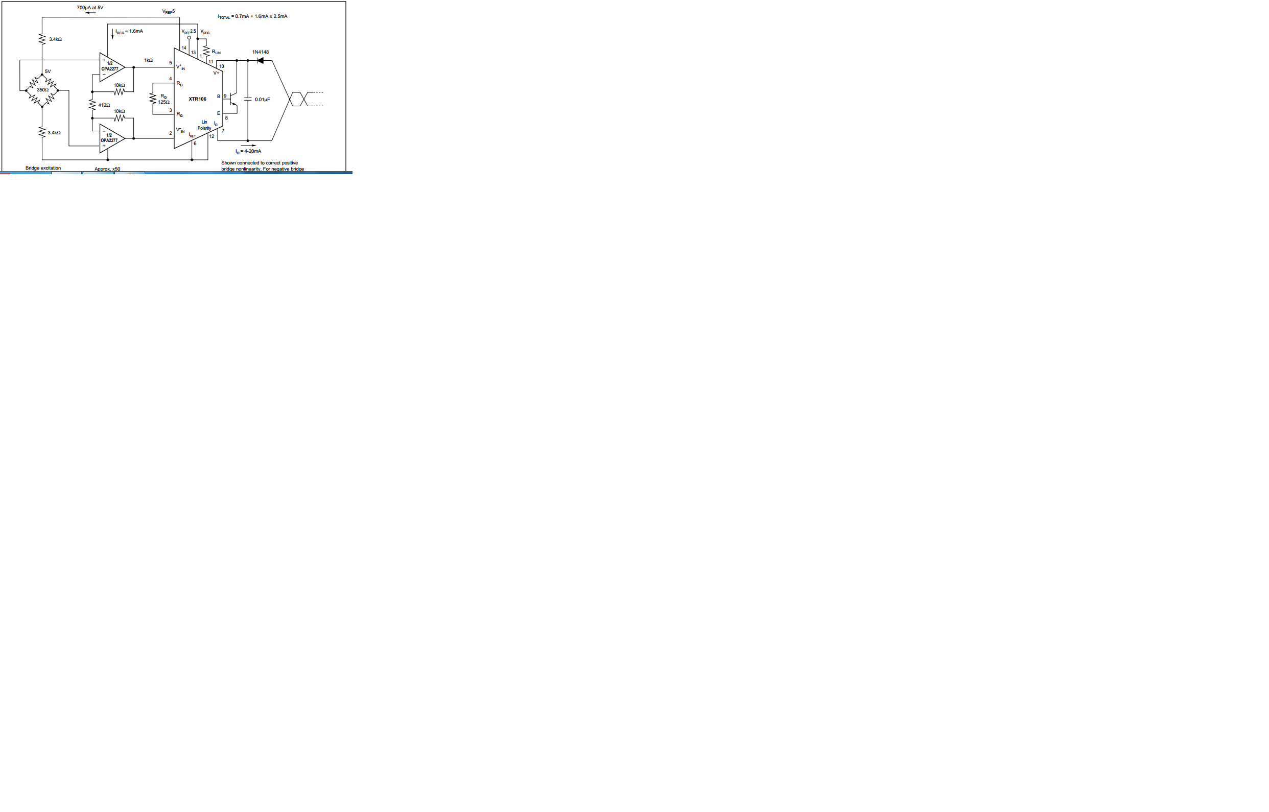

I am in the process of designing loadcell. .  I am using a Wheatstone bridge circuit to detect the difference in my voltages with the weight differences.  I am using two strain gauges both 350 ohm and two 350 ohm precision resistors.   I am using the opa2277 and xtr106 as my  amplifier and VtoI converter.I have connected my circuit as per xtr106 datasheet application note.
My problem is when i  connecting opa2277 output to xtr106,then it is loaded.i.e opa2277 output is 415mv means,after connected with xtr106 it is reduced to 15mv.kindly suggest me.
