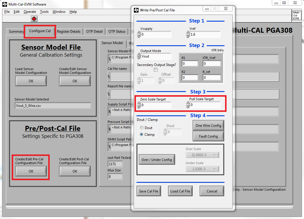

    1) We assume that the GUI for Multi-Cal software could be installed on following setup.exe file; sboc401a\Multi_CAL_PGA309 Installer\Volume
    When trying to use this GUI, I could not find out actual linear output range setting Tab on this tool.
    Please let us clarify which Tab could be used for setting within 1-5V range (1V=atmospheric pressure and 5V=maximum operating pressure applied)  linear characteristics.

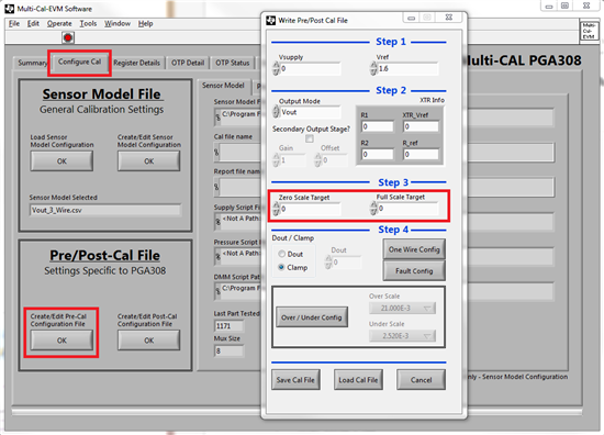

    1) You should be using software SBOC390 for the Multi-Cal PGA308 system. If this software is running on Windows 7, it must be run as an administrator for proper functionality.
    To specify the output span, click the "Configure Cal" tab, then click the "Create/Edit Pre-Cal Configuration File" button. This window is where you set all sensor module parameters. I recommend you start by loading one of the default settings and making modifications, rather than starting from an empty configuration.

    1) I re-installed SBOC390 in my PC, then tried to find the "Configure Cal" tab. However, it seems that the program itself is slightly different from your captured one.
    Please let me clarify whether I could have multi calibration with the command "Create Pre Cal Config File" on this tool. (without connecting to boards, it seems that any additional windows are opened despite clicking this icon.)
