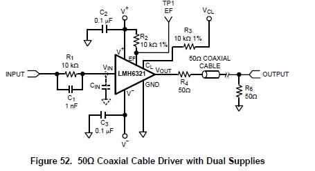

I've got an LMH6321 design which worked fine in the previous version but is now failing in an odd way.  I'm attaching a schematic sketch which shows the two versions, working and not working.  The symptoms are that the current limit pin (CL) is pulling to +15 V instead of staying at virtual ground, and the output is slightly unstable at high levels.
The main problem seems to be CL pin pulling high.  If I lay a finger on CL the instability goes away, and there is a distinct difference between the old circuit CL (at ground potential as it ought to be) and the new CL (at +15 V).
The input to the LMH6321 is identical for both versions, and I've added a couple of (what I thought were) harmless things on the output which has caused the problem.  The main difference is AC coupling on the output, but I have tried shorting the 10u AC coupler and that doesn't help.  I've also tried removing the 38.3k pullup AND shorting the 10u AC coupler, and I've tried putting a 50 ohm load to ground with all that in place.  Nothing makes the CL (pin 7) go to ground potential as it should.
I've checked all the supplies and connections to the LMH6321, all the passive component values in the circuit, and even replaced the LMH6321 itself.  The problem remains.  If I power up an old (working) board (with no signal input) the CL pin is at ground potential as it ought to be, and if I power up a new one (doesn't work) CL is at 15 V and the output shows the slight instability when I apply a large signal.
The PCB layout between the two versions is almost identical, too, especially for the power and decoupler connections.  It's not shown on the sketch, but the power tab is connected to -15V.

  • Hello Gerrit,
    Sorry to hear about all the trouble you have had while trying to get the issue resolved. Looking at the circuit, I am a little confused with the bottom-most amplifier which looks like it is trying to set a mid-bias shift. I dont see how the loop for that particular amplifier is getting closed. Is something missing in the schematic?
    -Samir
  • Hi Samir,
    That bottom-most amp is just a comparator, so its loop isn't closed.
    Gerrit

    One thing I found out in your drawn schematic is that you have connected pin 5 & pin 7 via a 30.1kohm resistor. I assume that you are using a 7-pin DDPAK package. Is there a reason instead of connecting pin 5 & 6 together, you have connected pin 5 & 7 as shown in the Application circuit? You should be connected to V+ and EF instead of V+ and VCL, right?
    Gerrit
  • VCL in the app note figure is +15 in my circuit, and R3 in the app note is my 30.1k resistor.  CL connected to +15 through 30.1k just sets my current limit.
    Pin 6 on the DDPAK package is the EF output, and I'm not using that so I've left it open.
    Gerrit

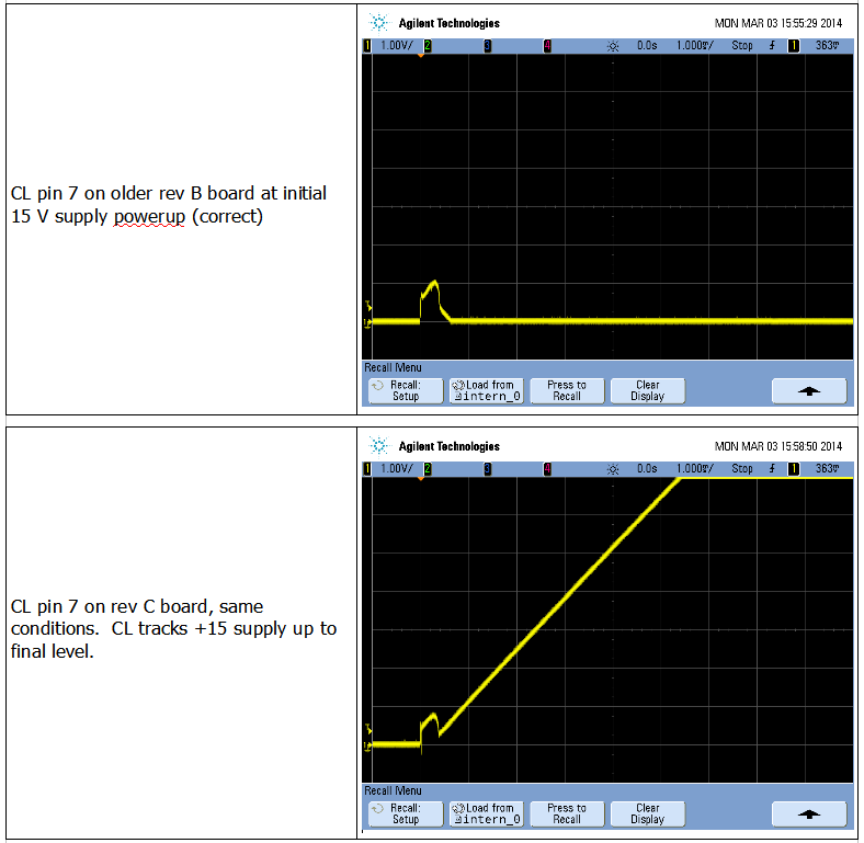

  • Here are some bench notes:
    • Varying +/- 15 does not cause CL to go to virtual ground.  It just follows the + supply level, even down below 10 V.
    • The 100k resistor to the comparator input is difficult to remove, and I really don't think that could be the problem.
    • The 30.1k current limit resistor does read 30.1k with an ohmmeter.
    • I'm attaching scope shots of the CL pin on a rev B board (working) and rev C (not working) when the 15 V supplies are first turned on.  On a good board the pin follows +15 until just over 1 V when the LMH6321 internal loop starts working and pulls it down to virtual ground.  On a bad board it begins to work but then fails and follows the 15 V supply up.  The CL pin does seem to be a diode drop or so below the 15 V supply.
    Any ideas?  Thanks for the help.

  • Hello Garrit,
    It is strange that with the increase/decrease of supply voltage, the CL pin is not returning to virtual ground. So, you are seeing a diode drop or so below the 15V supply which confirms us that the internal loop of the V/I converter is not working. I am not sure whether you have noticed the supply current of the board, but it would be a good idea to look into that as well, just to know if the part is placed into Thermal shutdown, you would measure the non working pc board current 8mA lower than the working pc board. Also, it might be worthwhile to note the voltage at the EF pin as well, as this might give us some clue as to whether if it is a low voltage, the part might be in thermal shutdown.
    Also, I am not sure whether you are doing power up sequencing or not on your pcb, but sometimes we have noticed that, not having power up sequencing on the board upon startup throws off the amplifier, not just LMH6321, into an unknown state. There might have been a latency between turning the supply of internal amplifier in V/I converter of LMH6321 and the input of CL for first time, which might even cause damage to the input of the internal amplifier. This latency might have been small for the working pcb.
    It might be worthwhile to remove the 30.1k ohm resistor by keeping CL open and just power on the part as well to check and see if CL tracks the V+ supply.
    Rohit
  • Hello Gerrit,
    I'm stumped.
    Things I'd check again:
    Pin 7 is really connected to V+ only through the resistor.
    Pin 2 is solidly connected to ground (no missing vias etc).
    Pins 1,3 are staying at ground when no signal is present.
    No solder bridges or such between adjacent pins.
    Review new board layout compared to old one in particular traces connecting to pins 1,3,7.
    I would be very surprised if your changes to the device output caused this, I'm still leaning heavily towards some kind of change that has so far escaped notice.
    As to the cap to ground on the Vcl pin.  Capacitance to ground on the inverting input can be risky, since Rf = zero I think this is a low risk in this case.
    Loren
  • Thanks Loren -- you found it.  I thought I checked all the pins, but my ground pin is actually not connected.  In this version of board layout I used an Altium "net tie" instead of a jumper to tie two ground planes together, and that resulted in all my grounds around the LMH6321 not connecting to their local ground plane.
    Now I have to figure out if I can rework around this problem, but this is definitely the cause of my CL pin error.  Thanks to everyone for their help.
