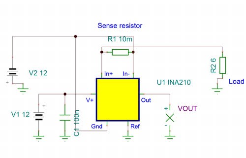

I'm building a dual rail psu with +/-12 volt rails, max 2A per rail output. I'd like to build current sensing into both positive and negative rails, I've chosen INA210 zero drift shunt monitor on cost/performance basis.
It is suitable for high side and low side measurement, but I'm not sure how to wire it to get a positive output voltage (need 0-5V) when connected to a sense resistor on the negative rail. Is this possible?

  • Allan, Are you planning to reference the INA210 to ground or to -12V? It may be possible to do this since the device is bidirectional and the common mode range is -0.3 to 26 V, but let me confirm that and I'll let you know tomorrow. - Jason Bridgmon
  • Hi Jason,  Either Ground or negative rail can be used for ref, I think ground would be better option though.  Can power it from +12v rail.
    I've just tried a few different configurations in TinaTi  and this seems to work, do let me know if there is a better solution
    Thanks, Allan
  • Allan,
    What you are showing in your simulation is that you have referenced the INA210 to -12V, making the power supply equivalent to +24V, which is absolutely acceptable.  The common mode of this circuit is more positive than -12.3V, which relative to the shifted power supply, is greater than -0.3V, which is also acceptable.
    I ran your simulation myself and found the output to be 4V, which is 200 V/V * 10mOhm * 2A, which is correct.  This circuit looks like a good option, The only thing I would recommend in the real circuit is to decouple V2 to Gnd as well.

  • Jason,
    Thanks for the confirmation that the circuit is ok and everything is running within spec.
    Problem solved :-)
