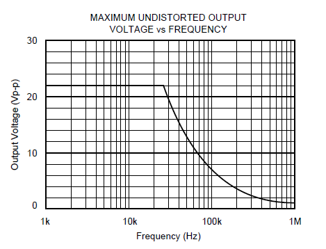

  • I use them for tuning high grade audio amplifiers and wonder that the OPA2111 sounds very well despite its low slew rate.
    In an other project I use OPA627 with best success.
    Which TI OPA are the dual channel model from the OPA627?
  • Friedrich,
    OPA2111 slew rate would only play a role if you exceed the full-power bandwidth shown in the graph below.  This would only happen at audio upper frequency of f=20kHz with the output peak-to-peak voltage of ~32Vpp or greater; f=SR/(Pi*Vout_pp) where SR is slew rate expressed in [V/us], Pi=~3.14, and Vout_pp is peak-to-peak output voltage.
    There is no dual version of OPA627 (it would be called OPA2627) but we have several other high fidelity JFET input audio dual op amps like OPA2134, OPA1642 and OPA1652, or bipolar input audio duals like OPA1602, OPA1612 and OPA1662.
