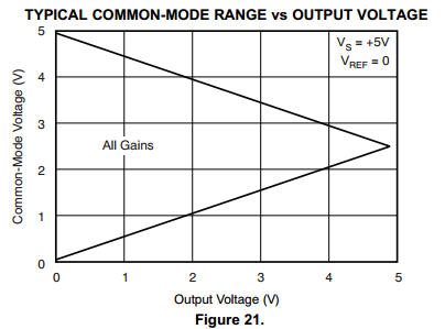

I have a very simple ina333 application with a static deltav of 10mv at the inputs, gain of 100, single supply +5,0V.  Vref set to 0V.
The output is 1V as expected with the common mode above 500mv.  Once the common mode drops below 500mv, the gain starts dropping off.   I see this in my board (unfortunately), and also in a Tina simulation.
Datasheet says cm > 100mv should work.
Why do I see gain changes below 500mv?
In the attached simulation, if you change V5 below 500mv you will see the gain gradually drop off.
