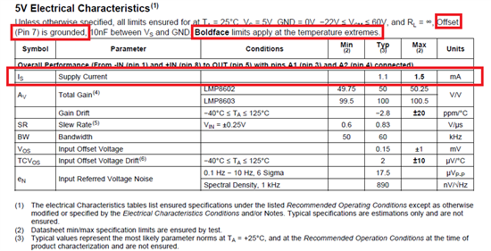

LMP8603 has "OFFSET" pin for bidirectional current sensing.
The output is 1/2 voltage applying the "OFFSET" is referenced to mid-rail voltage.
The datasheet indicates "OFFSET" pin tied to "VS" under such usage.
Is it no problem that "OFFSET" tied to another voltage source closed to "VS" voltage?
It could be utilized as output voltage offset adjustment if possible.
Is this kind of usage acceptable for LMP8603?
