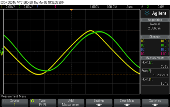

  • Dear Eugenio,
    with the Electronics guys in the lab I have set up the scheme of Figure 11 in the OPA552 datasheet correctly, and now it works.
    However, we have found out that the slew rate of this opamp is too low for our purposes. This is shown for instance in the picture that I attach, where the green line corresponds to the signal at the input and the yellow line correspond to the output signal. As you can see the yellow curve seems more a triangular wave rather that a sine.
    I wonder if you have alternatives to the OPA552 that I could use (consider the specification of the previous email, and add the constraint on the slew rate that have to be greater than 7V * 1MHz * 2 pi = 42 V/us).
    I will try the OPA551 as soon as I got it, but I think I will found the same issue on the slew rate.
