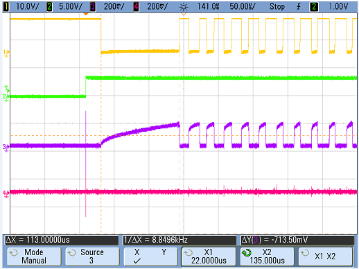

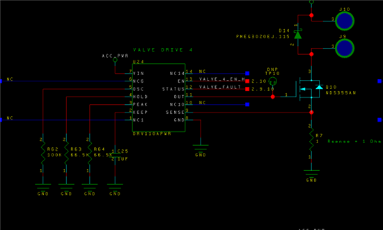

I am currently using a DRV110APWR driver to actuate a solenoid valve.  My configuration is such that pick time is 100mS (keep uF), Rsense is 1 ohm, OSC 100K, pick/hold current 1.2A/150mA (both 66.5K).  The circuit works appropriately 98% of the time, and occasionally glitches and goes directly to hold (pwm) after only 100uS.  The keep capacitor does not charge and the solenoid does not actuate.
There is a noise spike seen at Rsense when EN goes high, however filtering this has not resolved the issue.
The scope image below is a sample of a failed pick.
ch 1:  Solenoid (pulled through an nds355an)
ch 2: EN line at pin 13
ch 3: Rsense
ch 4: Ckeep
Any help will be greatly appreciated.

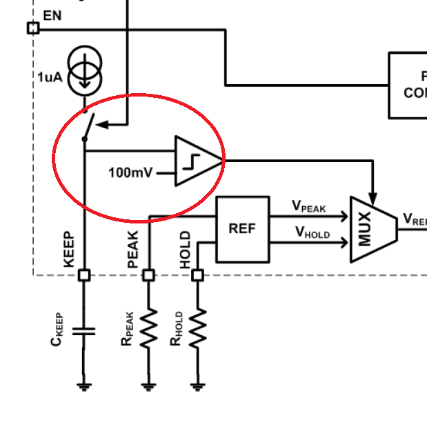

    I am concerned that the issue is occurring prior to the solenoid even being actuated, when the EN pin goes high (straight from MSP 430 @ 3.3V), the comparator is switching the VREF mux prematurely to VHold as described in my previous post.  VKeep sees a noise spike well before the gate drive turns the solenoid on.
    The DRV110 setup is here:

  • Answer is pretty strainght forward: the peak voltage seen on KEEP pin triggers the "KEEP" threshold of internal comparator therefore the device is automatically switching to the HOLD current regulation. So we need to understand the source of this spike, but we don't see how it could come from the device itself. Would it be possible that some cross coupling at PCB level may interfere with KEEP signal? I can review PCB layout if you'd like to see whether this could ocur or not.
