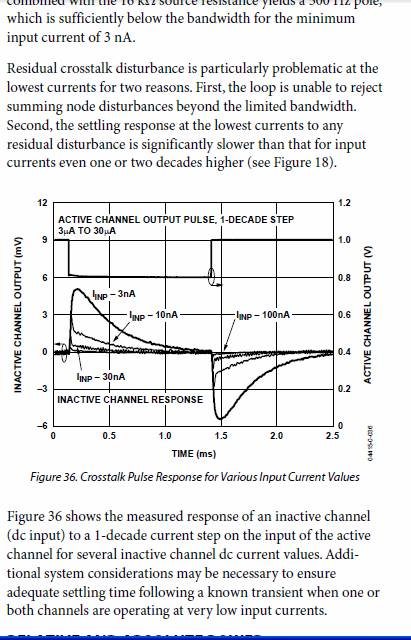

Does there have description like the #LOG2112 Miniizing Crosstalk?
Pleases reference #ADL5310 as attached describe

I found and reviewed the original LOG2112 characterization data taken in 2002. The LOG2112 was not characterized for crosstalk. The description and information that you have included are applicable to dual log amplifiers, but because the LOG2112 was not characterized in this manner we do not have this specific information.
