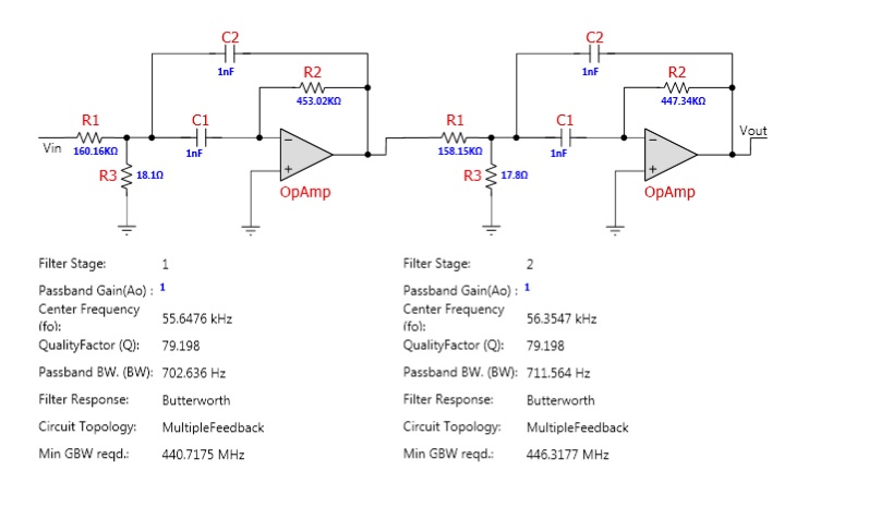

  • Hello Thomas,
    Thanks a lot for your reply. I have checked the filterpro software and have designed a BPF as per the specifications you said and have obtained a 2 stage bpf. I have selected a bandpass BW : 1Khz and stopband BW: 10khz. I have attached the obtained result
    1. As per my knowlwdge, 1st stage is for High pass and second stage is for low pass. what are the advantages of using two stages. can i design a single stage BPF. If so how can i?

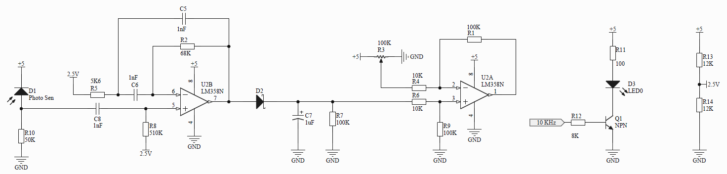

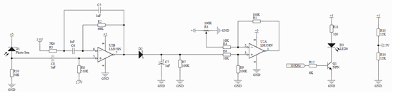

    I have found a circuit diagram in internet for Band pass at 10khz .
    3. I dont know if it is correct. But it would be very helpful if you could explain the main parts of circuit ( for ex: what is the use of second part of circuit i.e, after the peak detector and also about peak detector). If the circuit is correct which values could i change for 56 khz band pass ( with calculations)
    Each stage is a band-pass stage providing both a low-pass and high-pass response. The product of each of their individual responses produces the overall band-pass response. The advantage of two stages, over one, is the roll off outside the pass-band is 2x (40 dB) per decade, instead of 20 dB per decade. The higher roll off provides better rejection of signals outside the pass-band.
    The schematic is a little difficult to see; however, here is what I think it is accomplishing: The first stage has the photodiode input which is ac coupled via an RC to the first amplifier. The input RC sets up a high pass function. The stage itself looks to be a band-pass filter of some sort. It is followed by the Schottky rectifier with a parallel RC to ground that sets up the time constant for the peak detect. The second amplifier is a difference amplifier with a gain of 10 V/V. The dc level set by the R3 potentiometer will be subtracted form the rectified dc level and their difference will be gained up by 10x.
