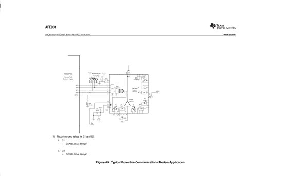

  • I am trying to do incremental tests on the AFE031, so the circuit that I am using is the following one:
  • Hello Victor Perone,
    At this point all I can offer is to review the signals in your SPI bus. I will be happy to check the signals you are transferring onto the AFE031; please include the signals on the DIN, SCLK, CS and DAC pins with the oscilloscope probes as close as possible to the AFE031.
    Jose
