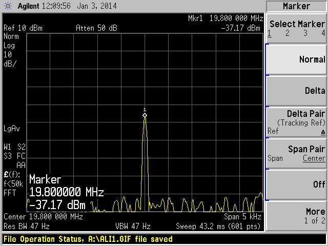

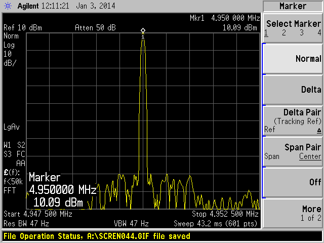

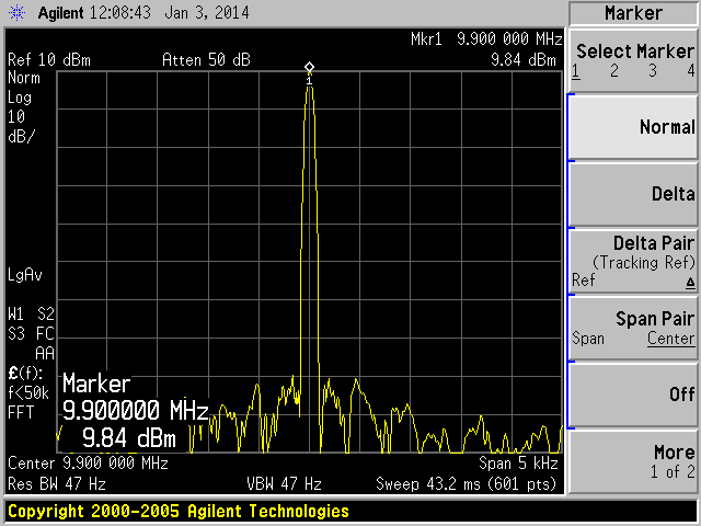

  • Here are my measurement results with new settings:
    9.9MHz fundamental signal
    19.8MHz HD2 signal
    4.95MHz fundamental signal
    9.9MHz HD2 signal
