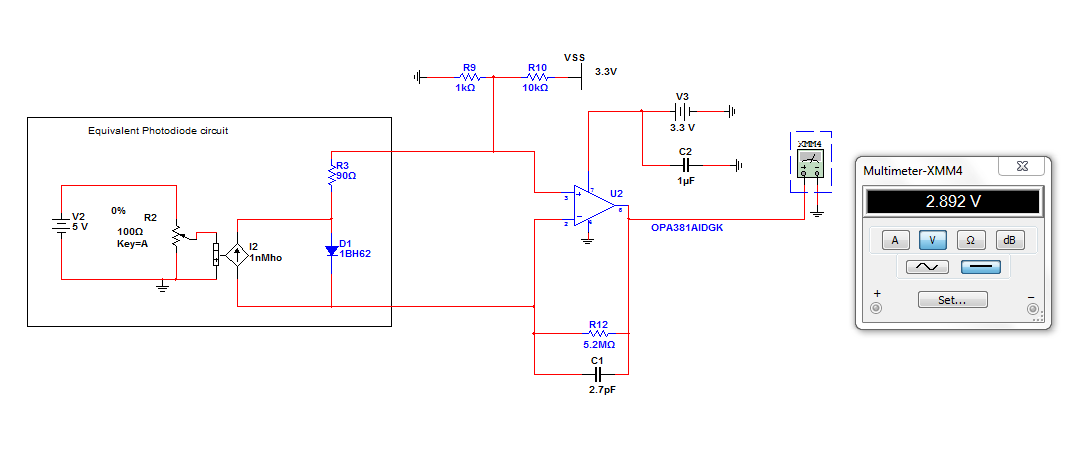

i follow ti note to attached with the photo sensor , why is the output voltage is 2.8 v while my dack current is 9nA.
below is my attached. is there any formula to calculated the output voltage.
  • Teo,
    Your OPA381 output is clearly driven to its positve rail: (V+)-500mV. Does your simulation shows 2.8V output voltage or do you measure it in an actual application?

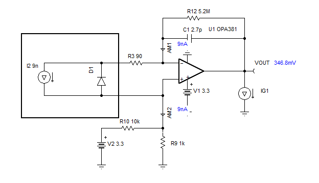

    If you simulate the circuit, do you run DC sweep or transient analysis; if you use transient analysis, please make sure your I2 photodiode current of 9nA, does not change with time.  I have simulated your simplified circuit and obtained expected result (Vout=~347mV); please see below and attached Tina-TI schematic.
    If you built the circuit, what kind of PCB do you use?  Is it possible that it has significant current leakages?  Also, please check the output with a scope for any sign of instability.
