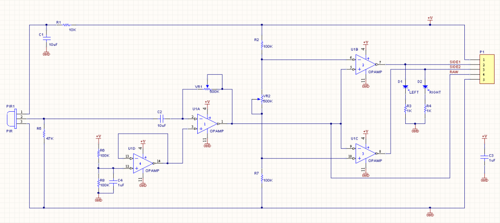

I am trying to design a low power analog interface to a PIR sensor.I have found a circuit utilizing LM324 for this , however I want to lower the power consumption using TLV2404.
Can I use the TLV2404 directly in place of LM324?
How should I further modify the circuit to give the lowest power consumption , perhaps by increasing resistor values?
