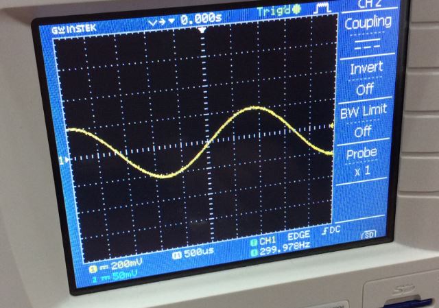

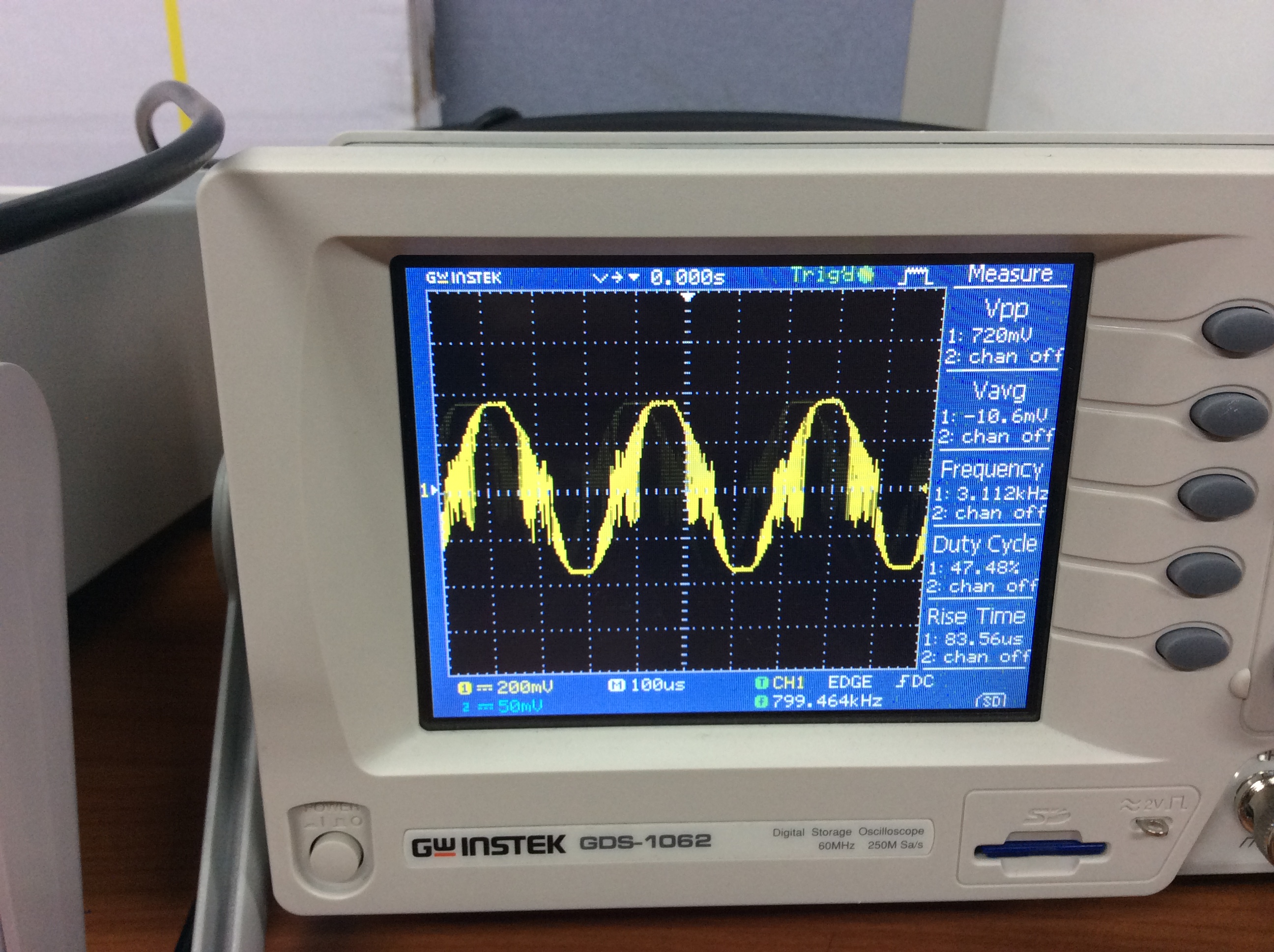

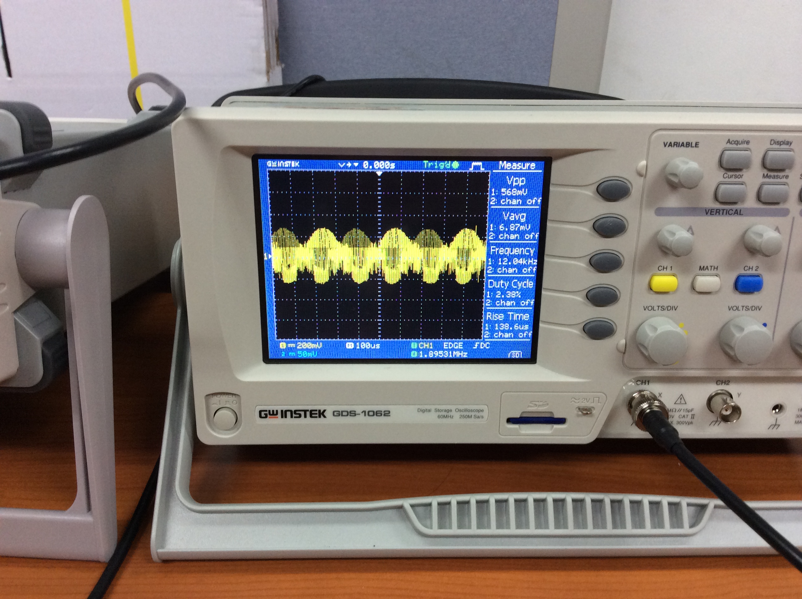

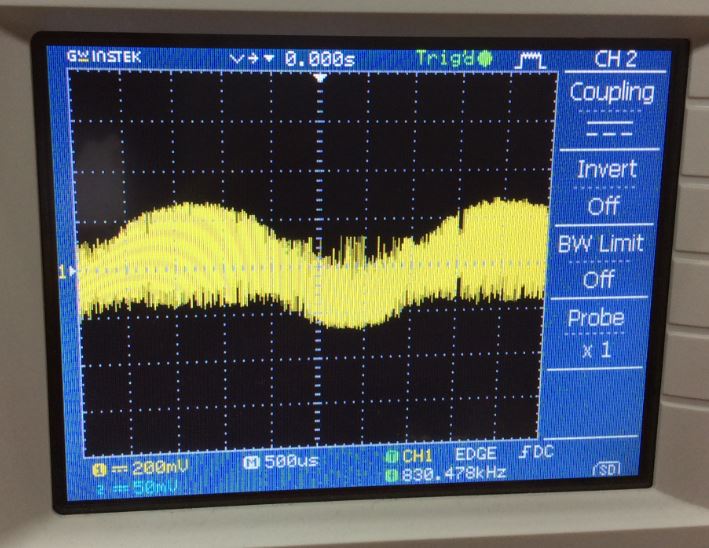

The high frequency noise(200kHz-1MHz!!) is concentrated as the current flow changes its sign from (+) to (-) and vice versa, AS I MEASURED VOLTAGE BETWEEN THE IMPEDANCE LOAD R9.
When the VG1 is set high(at 500mA-LEFT), the output sine wave still retains its intended form to acceptable degree, but when the input control VG1 is set low to allow for small current output(below 285mA-RIGHT), the noise signal completely wraps the output signal, rendering it useless for immediate use. (The Oscilloscope, due to impedance matching issues, displays twice the voltage that it should, so keep this in mind please)

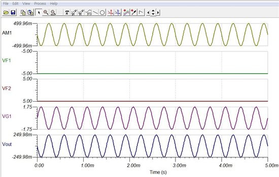

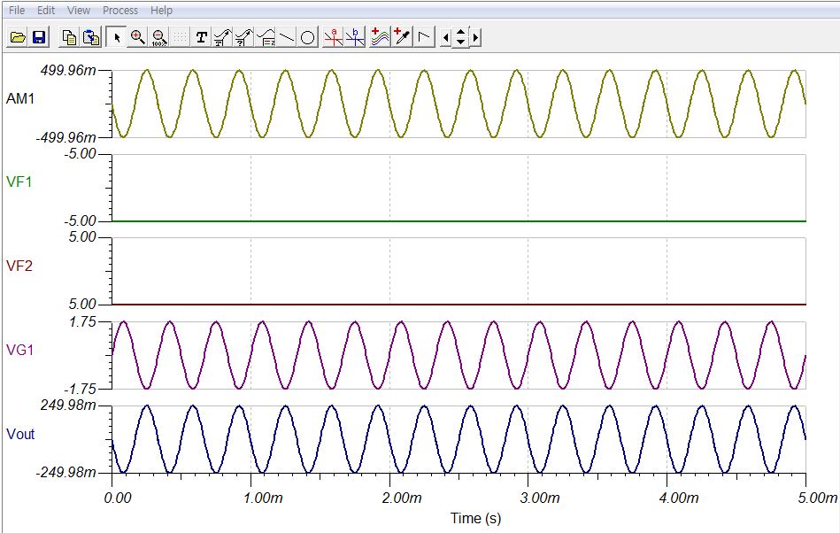

Below is the signal predicted from the TINA simulation....which didn't turn out the way I expected.
