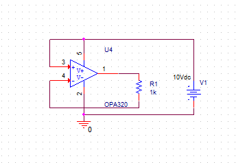

I have an issue using the PSPICE model for OPA320
following error message:

ERROR(ORPSIM-15142): Node N15494 is floating
ERROR(ORPSIM-15142): Node N15414 is floating
ERROR(ORPSIM-15142): Node IN_P_REG is floating
ERROR(ORPSIM-15142): Node X_U4.INPUT_OUTN is floating
ERROR(ORPSIM-15142): Node X_U4.INPUTN_CMRR is floating
ERROR(ORPSIM-15142): Node X_U4.INPUTN_ICMR is floating
ERROR(ORPSIM-15142): Node X_U5.INPUTP_CMRR is floating
ERROR(ORPSIM-15142): Node X_U5.INPUTP_ICMR is floating
ERROR(ORPSIM-15142): Node X_U5.INPUT_OUTP is floating
ERROR(ORPSIM-15142): Node LV_OUT is floating
ERROR(ORPSIM-15142): Node X_U6.INPUT_OUTN is floating
ERROR(ORPSIM-15142): Node X_U6.INPUTN_CMRR is floating
ERROR(ORPSIM-15142): Node X_U6.INPUTN_ICMR is floating
ERROR(ORPSIM-15142): Node X_U5.INPUT_VOS is floating
my regional orcad support center told me that the model is not constructed correct. is it true
