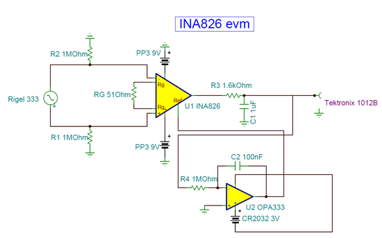

sorry for my English it is not my first language.
I am new to electronics.
I have a problem regarding INA826EVM.
I am trying to build a circuit on the INA826EVM board (see attachment for a schematic).
I am using Rigel 333 as an input of the instrumentation amp.( http://www.rigelmedical.com/downloads/rigel%20333%20instruction%20manual.pdf)
I set up the Rigel to Sine waveform with 1 Hz amplitude of 1 mV.
I am setting the gain close to 1000 with a 51 ohm resistor.
I am using R3 and C1 to create a low pass filter to cut at 100 Hz.
I am using Opa333 for the DC offset. The Rigel has an offset.
R1 and R2 are used because the Rigel is floating.
I am expecting to measure about a 1 volt to the output with a scope.
This will help me to calibrate the the circuit thus, I will be able to measure low level ecg signals accurately.
My problem is that in this situation the gain is about 592 and if I change the the frequency to 10 Hz the gain changes as well.
I have basic knowledge to electronics, haven't worked with much opamps and never with an instrumentation amplifier.
Thank you for the support,
