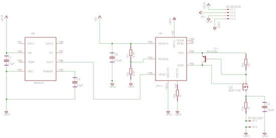

I am creating a Highly Accurate Constant Current Source for LED using REF5025I as a voltage reference that will provide me a constant voltage of 2.5V and connecting its ouput to the input of XTR111 to convert it into a constant current of 25mA (Rset= 1K)
My problem is that my XTR111 is getting very hot. A capacitor of 470 nF and two resistances(5.6K,8.2K) are connected across REGF and REGS pins. A mosfet BSP170P is also connected in the external current limiting circuit as shown in the datasheet application note.
Instead of these precautions,the IC is getting really very hot.What can be the reason for this and how can I rectify it so as to let my LED glow?
I have attached a bmp image of my schematic.
Thank you in advance
  • Hi Pratik,
    In your circuit R3 and R5 need to be 15 Ohms, not 15 kOhms.  What output current is the XTR111 delivering to the load while it is heating?

    I didn't notice the first time I looked at the schematic but the REF5025 output does not have the proper output capacitance and as a result the output voltage could be oscillating which would explain the large current consumption of the XTR111. Please read the "Basic Connections" section of the REF5025 datasheet which I've copied below:
    If placing a proper capacitor on the REF output does not solve this issue, please clarify a few things which will help me understand what's going on.

  • Ok Sir, I have inserted the Schematic and Board in this reply.

  • Hi Pratik,
    It looks like the PCB footprint you used for the XTR111 did not include the required PowerPAD connection to GND on the bottom of the IC.  The PowerPAD is shown in Figure 5 and the PCB layout requirements are described on page 21 of the datasheet. The device will not be able to properly dissipate power if the PowerPAD is left unconnected, explaining the heating issues you're experiencing.
    If you look at the PCB layout for the XTR111EVM you will see that the PowerPAD is included and properly connected to GND.
