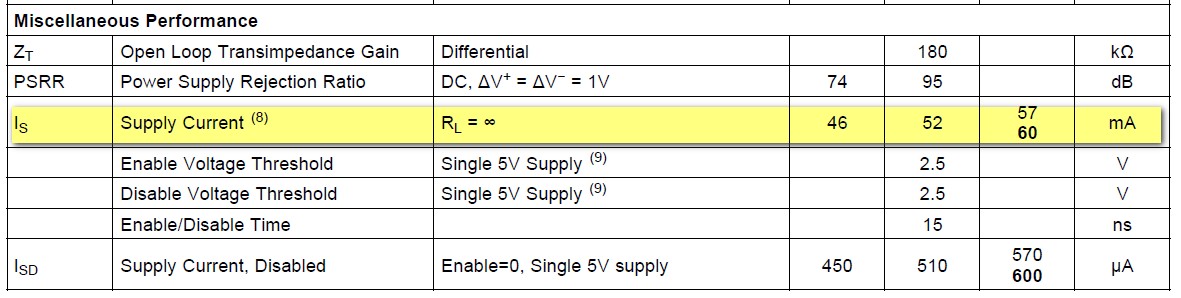

In the device datasheet I found the two types of currents.
IOUT=150mA and ISS=60mA.
For the power calculation or for the selection of regulator, which current I need to consider?
I need the information to consider the total power requirement by the card.
Please help me on this.
Amit K Bhat
  • Hello Amith,
    For each LMH6554 stage, this is the supply current information to consider, about 57mA Max room temperature supply current:
    This is the quiescent current draw of the LMH6554. If the load current is significant, you may have to consider its contribution as well. That would be dictated by the output voltage and your load impedance.

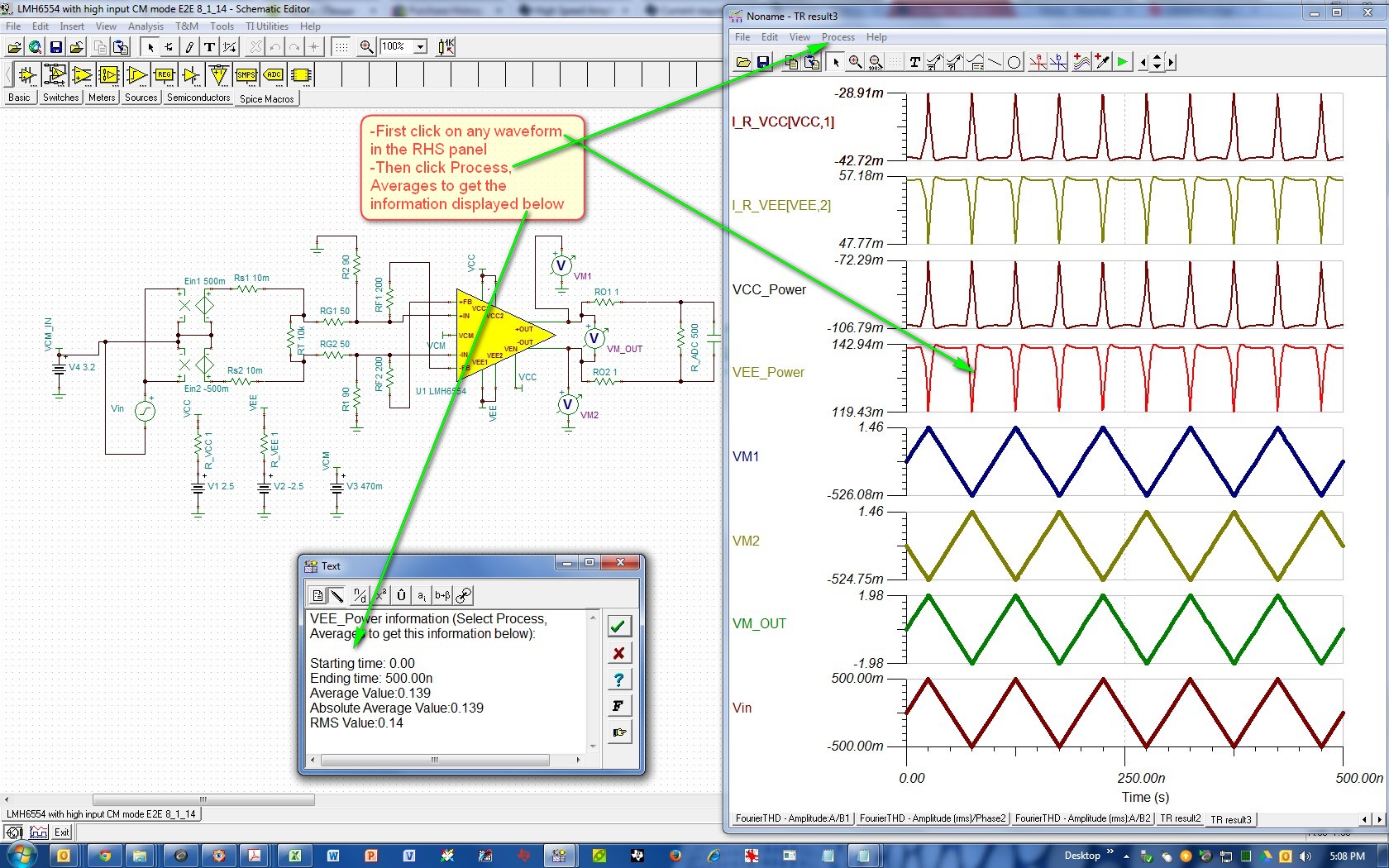

    You can also use TINA-TI to compute typical power dissipation as well, as shown below. I've created the VCC_Power and VEE_Power functions here and I find their RMS values using TINA-TI (this includes device quiescent power dissipation as well as the load power):
    Here is the TINA-TI file I've created / used for this purpose:
    6215.LMH6554 Power Computation E2E Hooman 8_19_14.TSC
    For the "Power" waveforms, in TINA-TI waveform display panel, you could select Process, Averages and the RMS and average information is displayed. Here is what I get with this circuit from performing Averages inside TINA-TI:
    VCC_Power:
    Average Value:-0.102
    Absolute Average Value:0.102
    RMS Value:0.102
    VEE_Power:
    Average Value:0.139
    Absolute Average Value:0.139
    RMS Value:0.14
    Total Power = 0.102W (for Vcc) + 0.14W (for Vee) = 0.242 Watt

    Something about the LMH6554 TINA-TI model:
    Earlier I had implied that the model predicts the supply current (V+ and V-) including the contribution from the load. I've since found that the TINA-TI model only accounts for the quiescent current and does not include the load current! So, please keep that in mind if you ever go the simulation route.
    Capacitive Load @ high frequency: A subtle supply current component is from the voltage swing across the ADC input capacitance. In the simulation below, I've found that it is about 3.4mA from both the V+ and the V- supply (0.8Vpp swing across 2pF ADC input at 700MHz). This is additional current that the LDO's / regulators much supply. I've used an Ammeter (I_C_load) in my TINA-TI file to show the ADC input capacitance transient current:
    Here is the TINA-TI file associated with the simulation above:
    6758.LMH6554 Power Computation E2E Hooman 8_19_14 Revised 8_20_14.TSC
