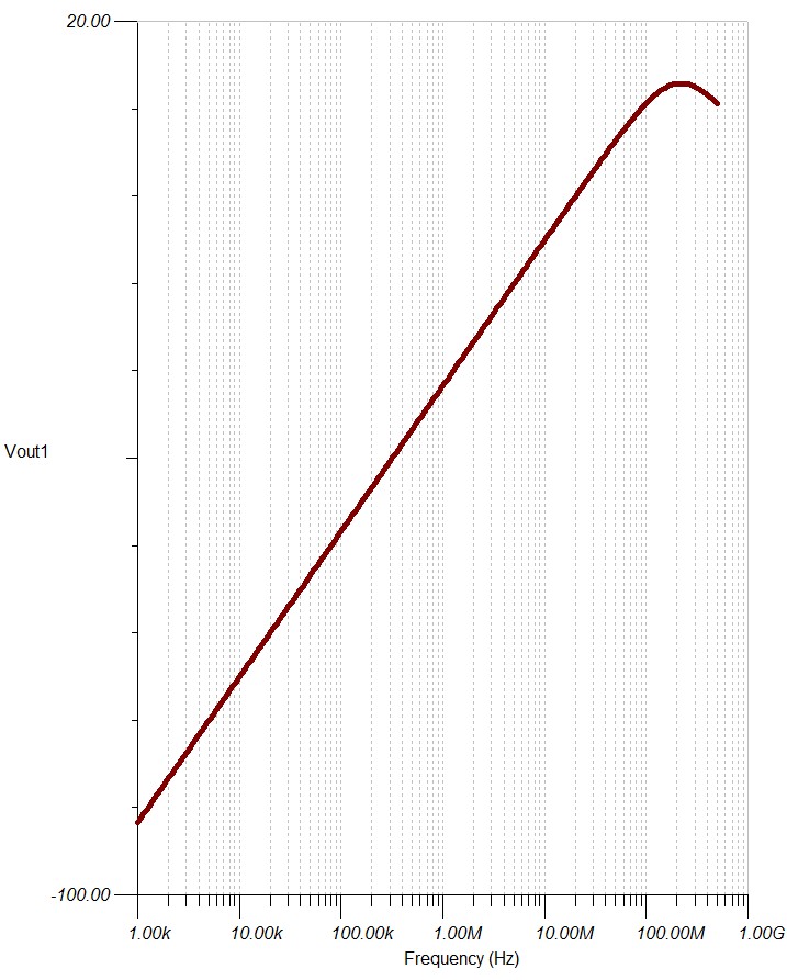

    In addition to the OPA836 that Samir has recommended, you can also consider a faster, lower noise device like the LMH6629. Here is a differentiator with 70MHz capability based on the LMH6629 (including components needed to make sure the circuit is stable):
    Here is the frequency response:

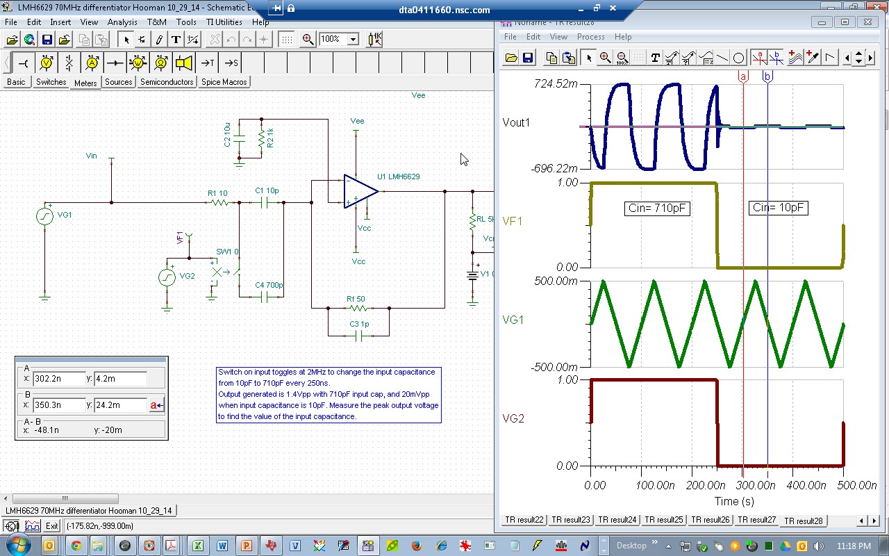

        Thank you for your reply.I just want to measure capacitance in the range of .01nF to .71nF. So I need a differentiator circuit whose  out put varies with capacitance in the above said range. I need out varies in 0 to 3 v range according to the capacitance. Vout= Vin*RC/t  is the equation for differentiator.
    If Vin=3V, f=70Mhz, C=.71nF(Max value), then R will be around 10. When i put all those value in the circuit you sent it show noise. And one more thing is that will thecircuit work if RC>t?
    Would you kind enough to help me?
    Thank you,
    Tharanath
    Here is a circuit which produces 1.4Vpp with 710pF input cap, and 20mVpp with 10pF (ratio of caps matches the ratio of voltages to confirm operation). However, my input ramp is only 10MHz, not 70MHz. What's the reason that you need a 70MHz test signal, as that makes it more challenging?
    6761.LMH6629 70MHz differentiator Hooman 10_29_14.TSC
    Note that I'm using the TINA-TI switch on the input to conveniently switch the cap value and view results of the min / max cap value simultaneously to verify ratiometric output. The circuit would only have the capacitor-under-test in series with the LMH6629 inverting input (no switch).

  • Hi Hooman,
            When I plot bode, After initial slop, next 20db slop start at 30Mhz? and next at 1Ghz? and 0db frequency around 2Ghz.But when I calculate answer not currect. see
    0db frequency=1/(2pi*10p*50)=200Mhz
    last slop frequency i can see in diagram is around 1GHz. but when i calculate is 1/(2pi*50*1p) is around 3Ghz.
