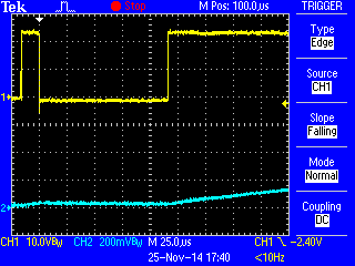

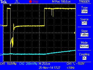

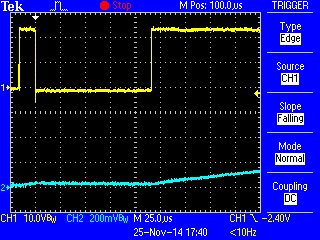

    I have attached scope traces showing the motor voltage transients.  Ch.1 is the voltage at J1-pin 1 on the attached schematic (10V/div).  Ch.2 is the motor current (2A/div).
    The first image shows motor turn on without the parallel diode. (trigger level is at -10V)
    The second image shows motor turn on with a parallel diode.  Note the trigger level is reduced to -2.4V. This is the level that the scope would actually capture the spike.  If the trigger were less, say -2.8V the event would not trigger.
    6281.INA195-SCH.pdf
    I'd be interested in your thoughts.
