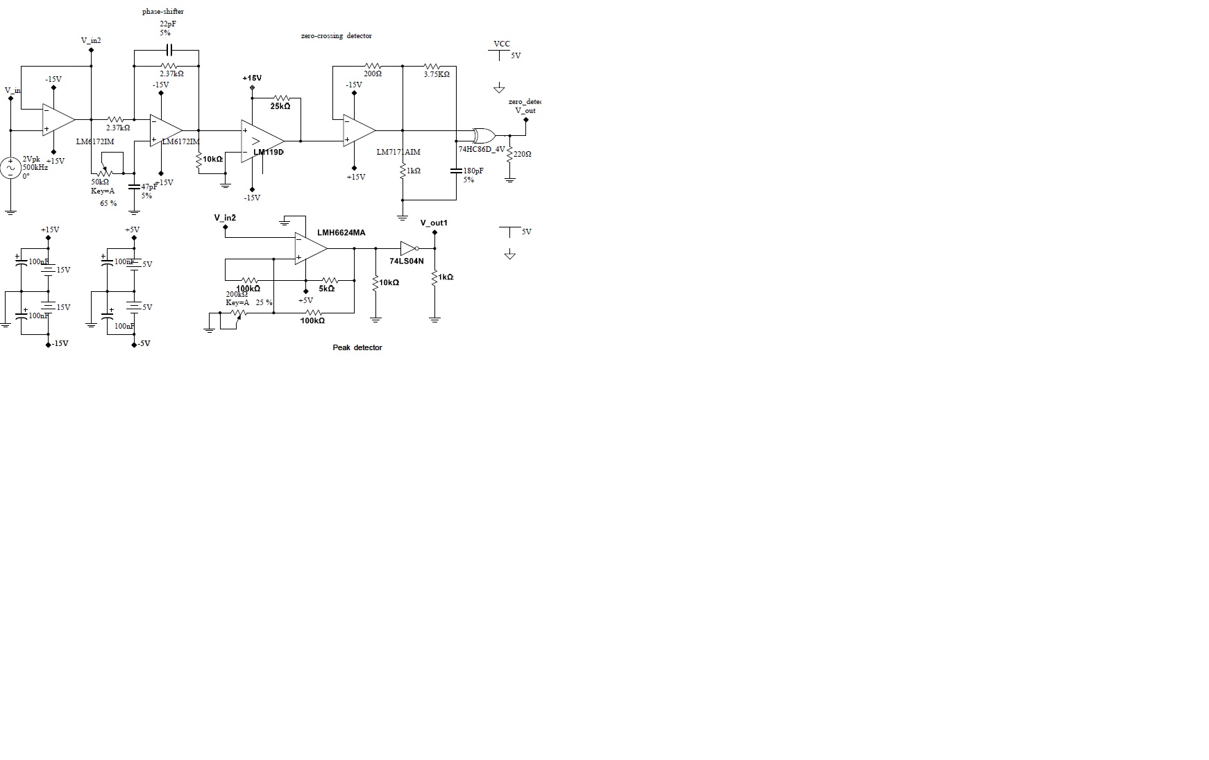

Peak & zero detector
I have a few questions regarding my circuits and hopefully someone can help me on this. I designed a circuit consists of peak and zero crossing detector circuits. Both of the output signals from peak and zero detector are connected to dcPIC30F6014a terminal to trigger measurement acquisition The operating frequency is from 10k-500kHz. The output signal from buffer (V_in2) is directly connected as input for the peak detector. I would like to know if this connection will distort the signal to the phase shift circuit? or is there any other way to combine both peak and zero crossing detector circuits? From simulation the signal looks fine, but I’m doubt the connections works in the real circuits. Thank you in advance.
