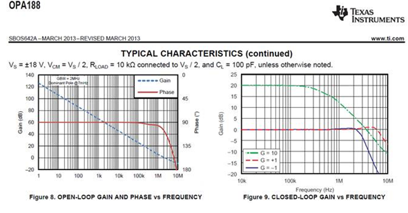

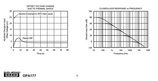

I found there is no low frequency information in closed-loop gain in OPA188 datasheet. Could you provide the information of low frequency in closed-loop gain like as OPA177? Thanks.
  • Henry,
    Knowing that OPA188 Gain-Bandwidth Product is 2MHz and that AOL slope is -20dB/decade, you may calulate -3dB frequency for any close-loop gain, Gcl, using following equation: f(Gain) = 2MHz/Gcl; therefore,
    for G=10, f=2MHz/10=200kHz
    for G=100, f=2MHz/100=20kHz
    for G=1000, f=2MHz/1000=2kHz
    for G=10,000, f=2MHz/10,000=200Hz, etc.

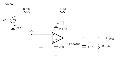

    You may also simulate it using OPA188 macro-model available on TI website where Gcl=Vout/Vin - see below.
    I have done the simulations for you by changing the value of R1 resistor for different close-loop gains-see below.
