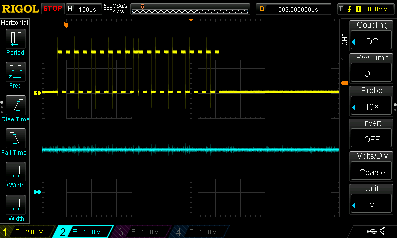

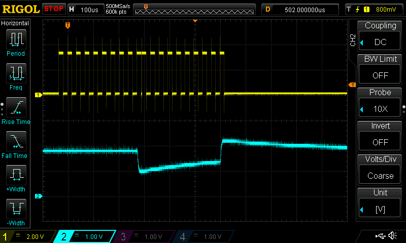

Then I toggle DAC pin of AFE031 to HIGH state, and send the data over SPI in zero bit mode. I always sending 2x10 bits as you can see on given images.
Below you can find the signals captured on SCLK (pin 3) and RX_PGA2 (pin 20) when I'm sending 0x1111, 0x5522, 0x0000, 0xFFFF.
Sending 0x1111
Sending 0x5522
Sending 0x0000
Sending 0xFFFF
The signal on RX_PGA2 (blue one) is a bit strange for me. How is this signal in conjunction with the signal I sent?

    In order to properly receive data the AFE031 needs to be in receiver mode; it cannot be place in calibration mode. The only purpose of calibration mode is to verify the gains in the signal chain.
    Hope this helps.
