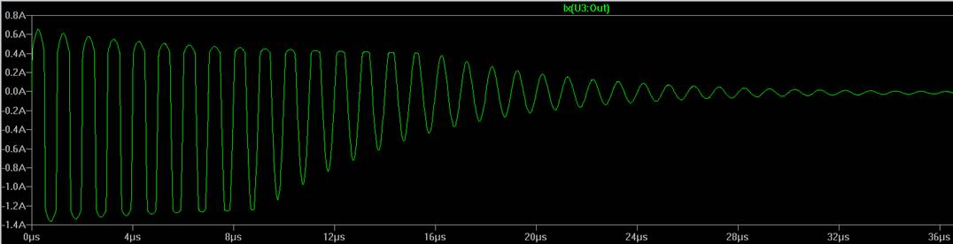

I’m trying to use the THS3120 for a design but am concerned about high current pulses in my system on the output pin. The datasheet only specifies the continuous output current capability, which is 550mA. There are two pulses we are concerned about:
First, a 2A pulse over 100us.
Second, a decaying 1MHz signal with the waveform below.
Will either pulse damage the part?
If it can’t be supported, is there a different device in the portfolio with comparable specs that can support it? If not is there an additional circuit that could be placed on the output to buffer the signal?
