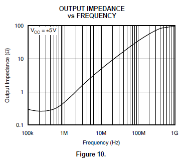

  • John,
    The output impedance is a function of the collector current as well as frequency - see below.  Since in bipolar transistor ro~1/Ic, decreasing the quiescent current from 14mA to 0.85mA, will result in approximately 16x increase in the low frequency open-loop output impedance.  But since the graph below shows a close-loop output impedance of 0.3 ohm at DC, which translates into an open-loop output impedance of around 3kohm (typical DC AOL=78dB), I would guesstimate in a shutdown mode its close-loop output impedance to increase to about 5 ohm while open-loop output impedance to be around 100 ohm.
    If you are truly concern about any audible noise created by OPA1632 shutdown function, the only way to know for sure is to test it in the specific application with specific headphones (speakers).
