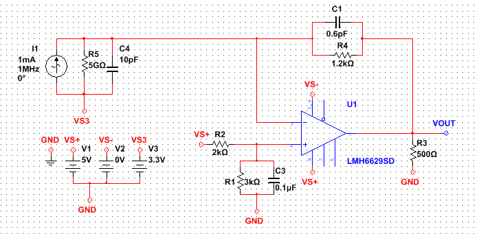

I am designing a visible light communication receiver that uses LMH6629 is the transimpedance. I did a (Multisim) simulation of the circuit on page 28 to confirm the 200MHz bandwidth indicated on that page but my simulation indicates a much lesser bandwith (~20MHz) . Below is the frequency response of the circuit, the Multisim model, and the snapshot of the circuit. Can you please help me figure out if I am doing something wrong ?
    Looking at the amplitude portion of the frequency response, it looks like it is peaking at a frequency > 100MHz. That would suggest the BW is also > 100MHz, so I am not sure how you are getting the 20MHz number. Also, the peaking in the frequency response looks to be around 5dB. this could cause your transient response to have some overshoot. I would suggest increasing C1 a little more so you can get a flatter response. Page 29 of the datasheet has some guidelines on finding optimum Rs and Cs to maximize BW.

    You are right about overshoots in the transient response of the circuit. I adjusted C1 and it produces very good results (no peaking) . I thought ~20MHz was the "practical" bandwidth of the circuit since that was the point where the amplitude stopped its flatness. Beyond that point the transient response of the circuit was pretty bad.

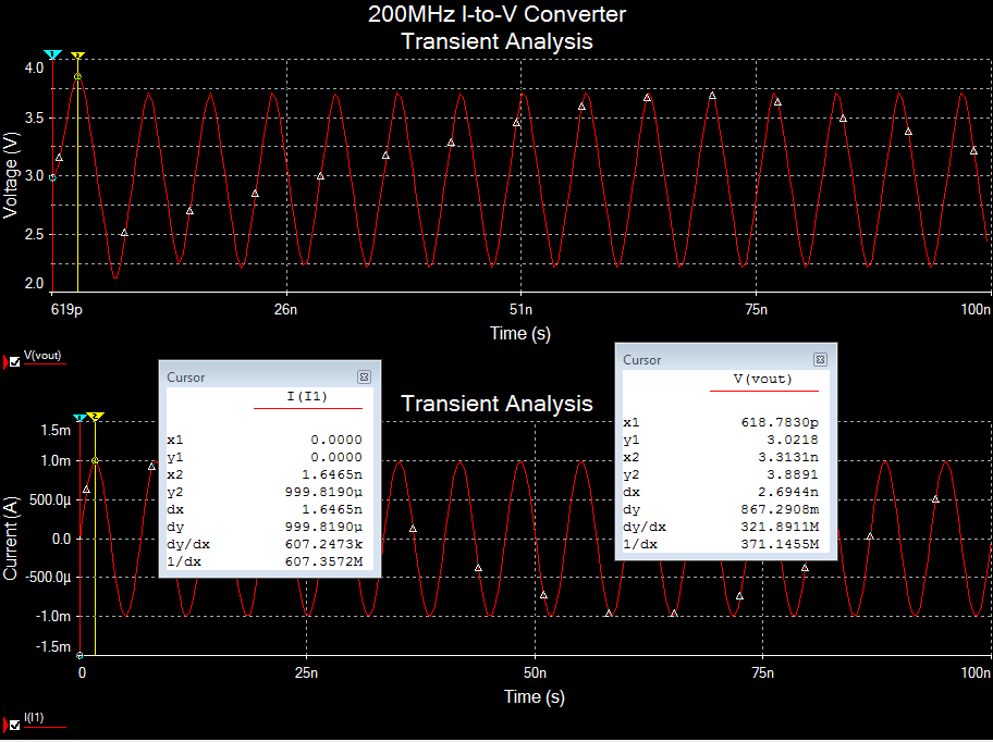

    After C1 adjustment though, the circuit was overall good up until for signals that are 80+MHz fast. Below is a transient response for 150MHz signal. Seems this time there is about 2ns difference at when they both peak (input signal leads). Also for the first few ps, the circuit looks unstable. Do you have any thought on what's possible causing this?

      The time-difference between the signals is because of the limited bandwidth and open loop gain of the amplifier. With regards to the initial non linearity, i am not entirely sure what could be causing that. Couple of thoughts are:
    1. Simulation tool trying to find the correct bias point.
    2. Insufficient phase-margin in the circuit causing transient issues. This is probably less likely given the flatness of your amplitude response.

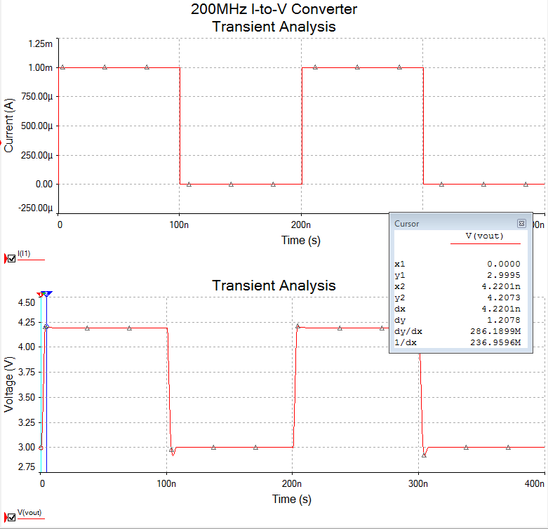

    With a 1ps rise/fall time150MHz input signal, there aren't lots of overshoots/undershoots except a tiny overshoot at the beginning (see the graph below). However this affect the output Vpp (decreases) but overall the circuit is stable around 150MHz.. By the way, would this also be applicable (using a fast square input signal) when stability/phase margin at small frequencies though?
    When analyzing an amplifiers response to a pulse, we do not need a repetitive signal. What I do is to provide the amplifier with a fast (1ps) positive going single pulse and study the response for overshoots. I then provide it with a separate negative going single pulse and study the overshoot. The high freuqnecy content is contained in the fast edges. We are studying the response to these fast edges. I would redo the analysis with the above setup. Hope this was clear.
    One more thing to remember is that BW and rise/fall time are inter-related by the equation BW = 0.35/Rise time. So if you input a very fast signal (1ps) into an amplifier with 150MHz BW, the output of the amplifier should have a rise time of 2.33ns.

  • I cannot study any overshoot/ringing behavior based on the last results. The reason is that the negative going edge occurs before the complete amplifier response to the positive edge has occurred. Reduce the frequency of your input to 5MHz and rerun the simulation. Because of the low frequency input we will be able to study how the signal settles.
  • These are the results I am getting when I change the input freq to 5MHz. Does this mean our circuit is not stable at low frequencies?
  • It doesnt look like there is too much overshoot/undershoot at the rising & falling edge so you should be fine. Generally < 10% overshoot indicates sufficient phase margin. So, in your case your output moves around 1.25V, so you ideally want < 125mV of overshoot or undershoot at the edges.
