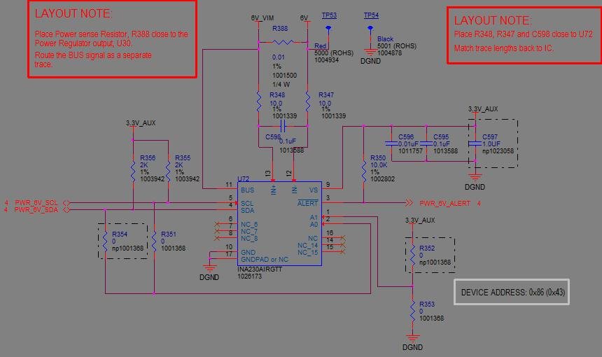

INA230 - BUS Pin
Other Parts Discussed in Thread: INA230
I've got a circuit utilizing an INA230 to monitor a 6V rail.  The chip itself is powered from a 3.3V rail.  We've noticed that when the 6V rail is disabled, the net is back-fed through the BUS pin.  The 3.3V applied to the part results in around 2.7V on the 6V rail.  Is there a way to prevent this?  We're considering putting a diode in-line with the BUS pin but that affects the reading of the bus voltage.
