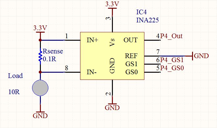

I am having problems with the voltage output from the INA225. I'm only seeing approximately 25mV on Vout with the following settings derived using the example in the data sheet.
IMax = 1A
Vout Fullscale = 3.3V
Gain = 25v
RSense = 100mΩ
My load is a 10 Ohm Resistor. What should I be seeing on Vout? I've tried a variation of RSense values and I always seem to have a small Vout. Vout does change although it is very minute as its such a small voltage.
Any help would be great,
Pauric
