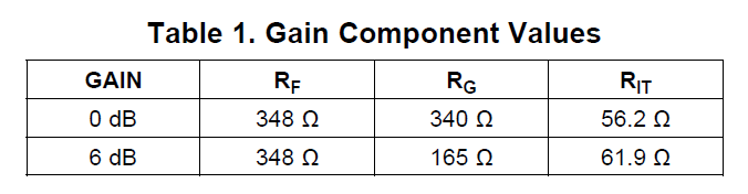

I am studying THS4513 to support my customer.
I would like to ask you a basic question about Gain setting resister as below.
There is a "Table1 Gain Component Values" on page23, datasheet.
I do not understand how to calcurate RG, RIT.
Could you tell me the equation or formula?
And about RF, 348 ohm is used. Why is this value adopted?
For example, " Kohm"(1K, 2K, etc) value is not appropriate?
