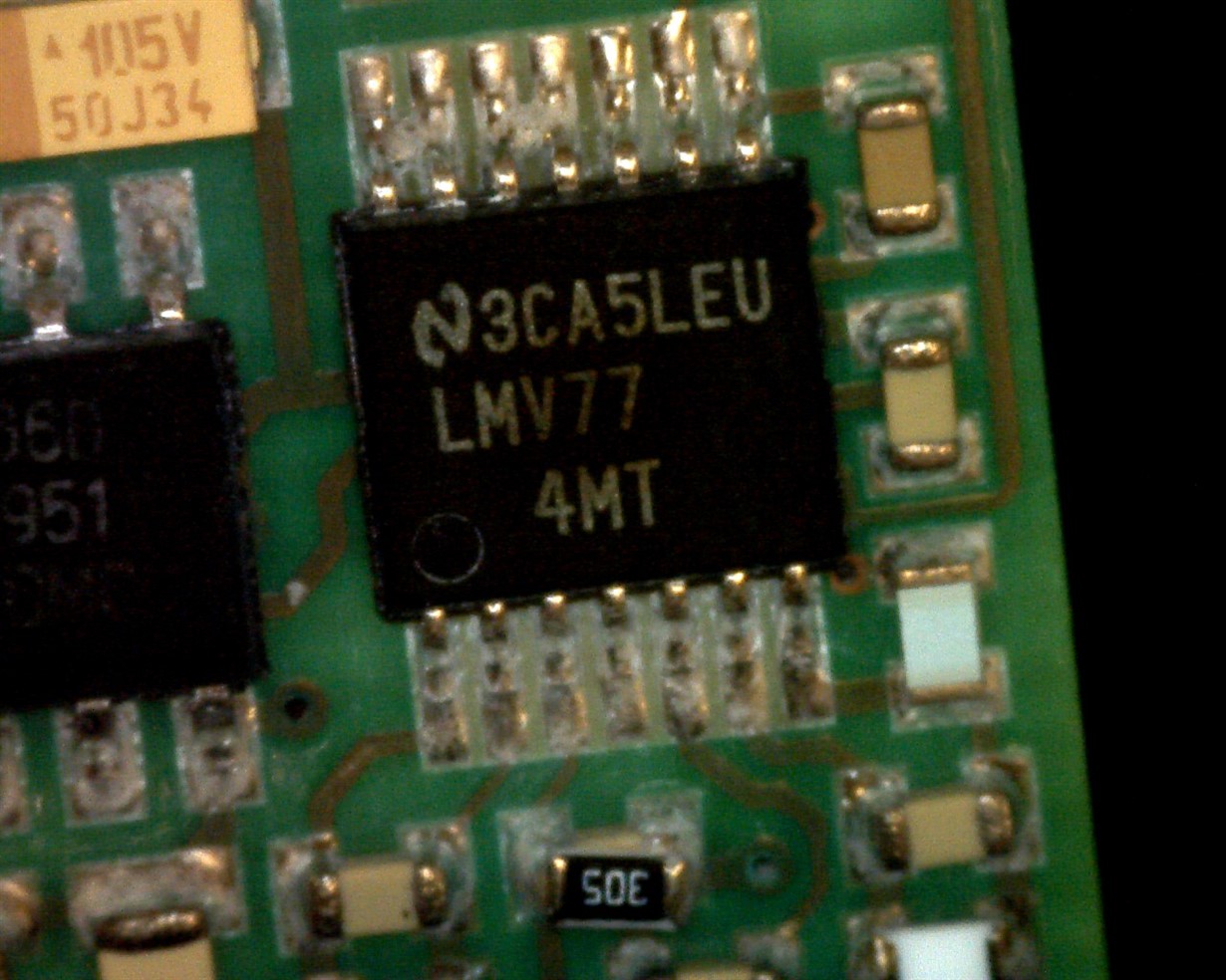

I am trying to diagnose why an intermittent failure occurred in a 4-20mA transmitter. The output of the failed unit was pinned at a very low mA output. At the time of the failure, severe thunderstorms were present in the area. The unit was unplugged and then powered back on and the unit did not recover to it's normal operation. After opening up the device (a welded housing), I noticed the LMV774 Op-Amp on the PCB had a scorch mark on it's surface. This brown discoloration indicates that this part was overheated. Given the nature of the weather, I suppose the unit saw an ESD, Surge, etc. Since the unit operates through a current loop, it is not grounded. When I probed the LMV774 op-amp, I noticed the pin out voltages were correct.

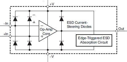

  • Hi Keith,
    Below is the typical ESD protection on modern devices.
    The "diodes" are ESD structures from each input or output pin to each supply. These clamp any excess voltage (>0.5V) to the respective supply line.
    Across the supply line is a larger protection structure. If the voltage between the V- and V+ lines rises quickly (<1V/us), it clamps the supplies together.
    Keep in mind the ESD strictures are there to protect the op-amp - not the circuit. The structures work together to keep the voltage across the die to a safe level for the circuits on the die.
    It is possible for ANY integrated circuit to latch-up if the external transients overwhelm the protection (as in a "Natural ESD event from the sky" ). Latching-up is not necessarily destructive, but it is damaging, particularly if it causes excess currents to flow through places that were not designed to handle (any) currents..
    The device may seem to still be "functioning", but you may find it has been "impaired" at some point (high offset voltage, reduced output drive, instability, high bias currents, etc). Most likely it will no longer meet datasheet specs.
    If enough supply/source current is available, it is possible for the device to heat up short of melting and still operate ("Operate" means it still wiggles - but not as well as before). Silicon can survive well past 150°C, though usually not the packages or PCB. I have seen devices heat up and "burn" the board below, and still "work" afterwards.
    The latch-up occurs as long as current is still applied after the event. Removing power "resets" the latch to "normal" operation. Assuming you had to cut the welded case apart - the time was probably longer than a few minutes. I doubt if it "stored" charge internally for that long - but I would not rule it out.

    Can you provide a photo of the "mark"? Do other non-zapped boards have the same mark? If it is a wave soldering issue, other boards may show the same mark.

  • Paul,
    Thank you for responding so quickly, I really appreciate all of your feedback as it has been more than helpful. Above is a picture of the "scorch" mark on the Op-Amp. Our circuitry has a voltage regulator, transient voltage suppressor, as well as reverse polarity protection. I believe the TVS clamps at 48 Vdc and begins to breakdown at 33 Vdc min. The voltage regulator did not appear damaged and output a normal operating voltage of around 4.97Vdc (the input to the device is 9-30 VDC and the voltage regulator steps this down to 5Vdc.) If you look at the discoloration on the Op-Amp, you will see that it appears to be located in the center. After a quick check, no other PCB's in stock have this discoloration so that eliminates the heat wave soldering theory. The TVS and reverse polarity protecting diodes should have shunted any surges or transients from the internals of the device. If the pulse was rather quick then perhaps the rest of the circuit could have seen the surge however this would have most likely destroyed the voltage regulator. I believe? With protection of the overall circuit and protection on the Op-Amp itself, I am lead to believe that somehow the Op-Amp was overheated, perhaps over time (Note: this unit was running 24/7 for 6 months before failing; it just so happens that a sever lighting storm was present which makes all of these theories iffy). The other possibility is that an ESD occurred to the outside of the device (not through the terminals of the connector) and arched through the housing and to the PCB. This would negate any overvoltage, reverse polarity, etc. protection.

    The picture did not make it through (you must have 'pasted" it in). You have to click the "Use Rich Formatting" link in the lower right below and click the "Insert/Edit media" icon to the left of the paperclip icon to insert a picture file (TIF/GIP/JPG/PNG). Not convenient..I know..but that is what we are stuck with...

    A quick check of the op-amp is to check it's offset votlage, A quick way is to place it in a "normal" operating condition (not railed or some non-linear mode) and use a good millivolt meter to measure offset voltage directly across the input pins (+IN and -IN). At room temp, if it is greater than ±1mV, then it is bad. Any damage to the input stage generally causes an increase in offset voltage.

    Sorry for the delay in terms of the picture. I figured the picture would be fine to be pasted in a HTML "Word Environment". Attached is the picture of the scorched Op-Amp. Like I said yesterday, it starts from the center and spreads outward and decreases in intensity. It does not look like a "flash".
