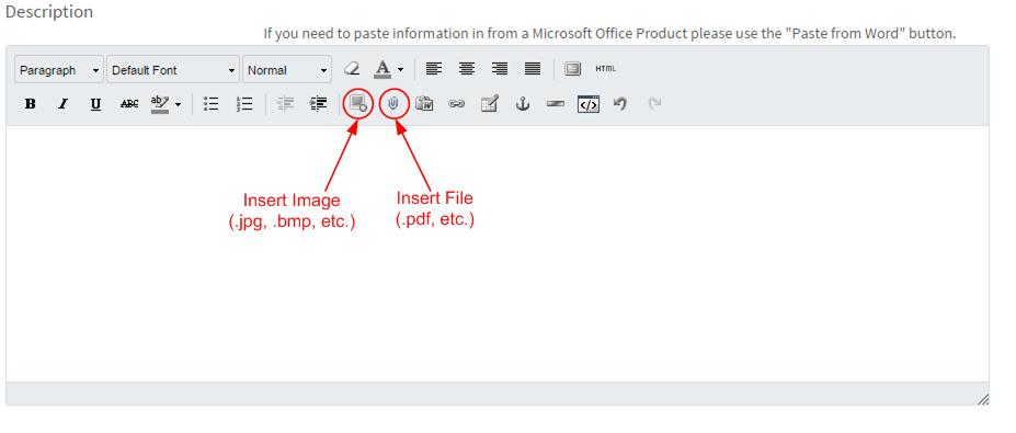

  • How can attach the pdf file or image here?
    Mike
  • Hi Mike,
    First, click on the "Use Rich Formatting" button at the bottom right of the reply area to use the rich formatting options for the E2E post.
    Then use click on either the "Insert Image" or "Insert File" buttons shown in the image below:
