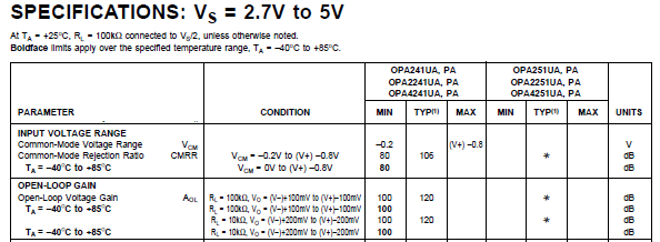

I am using OPA 4241 on a low power battery operated application.
When I connect VCC = 5 volts and VEE = 0 volt or -5 Volt I measure a DC current of 800uA which is much more than expected.
According to the datasheet Iq=~25uA so for 4 amplifiers it should be around 100uA.
The current remains high either when the inputs are floating or tied to ground .
There is no load at the output of the amplifiers.
Is there an explanation for the high current ?
