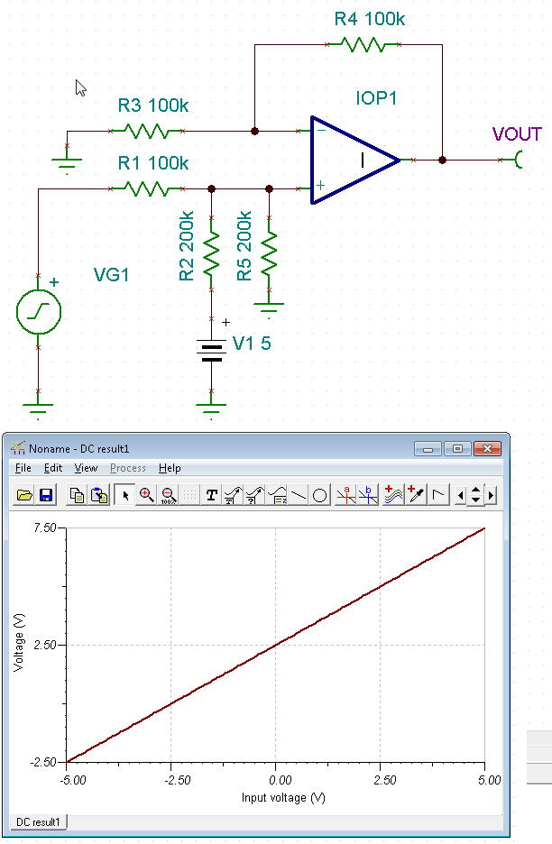

dc offset adder circuit using op amp
i am using this dc offset circuit. it does not work me
