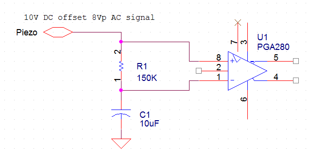

I'm planning to use PGA280 to amplify the signal from a piezo sensor before route it into the ADC. The ICP sensor has 8Vp AC signal with 10V DC offset. Since I need very low freq (down to 0.1 Hz) I must use electrolytic caps. So I'm wondering for a suitable input coupling scheme. Does anyone has suggestions?
I designed this one (see picture, please don't mind to the PGA280 pinout), simulated and tested and it seems to be good, but I've never seen something similar so I'm asking if it can have some drawback.
