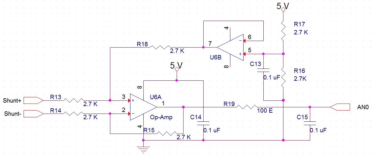

I am trying to monitor High Side current using Rail to Rail Op-Amp. The ouput of that Opamp if interfaced with a microcontroller and applied RMS algorithm and I could monitor with +/- 5 mVolts error, Is their any other method for better results.

    In this thread, it states that at a load current of 500A the shunt voltage is 75mV. Therefore I calculate the shunt resistance to be 75mV/500A=150uohms. At a max current of 10kA, the shunt voltage will be 10kA*150uohms=1.5V (contrary to the stated maximum voltage of 1V).
    As noted by Rabab, a current shunt monitor will not work in this case because you will require a small gain (e.g. if G=~3.33V/V the output will be approximately 5V, which is one of the typical ADC reference voltages). Therefore you will require either an instrumentation amplifier or difference amplifier (similar to the one you built in your initial post, though it only has a gain of 1V/V) where a smaller gain can be implemented.
    Given your 15V common-mode voltage, I do not recommend using an instrumentation amplifier because of common-mode voltage vs. output swing limitations. Therefore what you have already started to build is on the right track. While you could build your own difference amplifier with external resistors and an op amp, please be aware that you will get poor CMRR and resistor mismatch will introduce gain error.
    One option is to consider the INA146. With a single 5V supply, the common-mode range is sufficient for your application. You can use a couple external resistors to set the gain. Please be aware that the output swing is from 150mV to 4V, which is the voltage range that your ADC must convert. One other device that may be of interest is the REF2041, which is a dual-output reference. Given a 5V input, it will provide two precision voltage sources: 4.096V and 2.048V. I'm not exactly sure why you're providing a reference voltage of Vcc/2 to the difference amplifier, though, because this appears to be a uni-directional measurement. Finally, note that the INA146 has 1mV of offset (typical), so you may want to calibrate it out because it will limit your measurement resolution.

    As suggested If I use the Differential Op-Amp circuit as attached, Is their any other IC that could give us digital Output or direct Analog output, because the output of the operational amplifier is a sinusoidal wave swings on Vcc/2(2.5 Volts) and ADC with Zero cross detection would be more reliable but we are not able to handle zero cross detection. We have implemented true RMS algorithm by sampling multiple ADC outputs and the output is not consistent.

    The INA226 has a shunt voltage input range as shown below.
    At 10kA, your shunt voltage will be 1.5V, which is far beyond the acceptable range.
    Therefore you cannot use the INA226 or any other digital current shunt monitor with a shunt voltage that can reach 1.5V. Therefore you should use an analog conditioning circuit (e.g. INA146) and discrete ADC.
