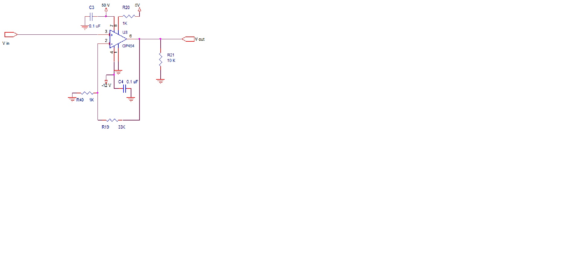

OPA 454 is connected as per the circuit for generating a 0 to 50 V output. V in is connected to a DAC having a voltage range from 0 - 3.3 V.
Also the power pad is connected to -12 VDC. But OPA 454 is getting burnt within some time.
Is there any problem in the connection, please help.
Also the 50 V and -12 V is used by some other circuits.
