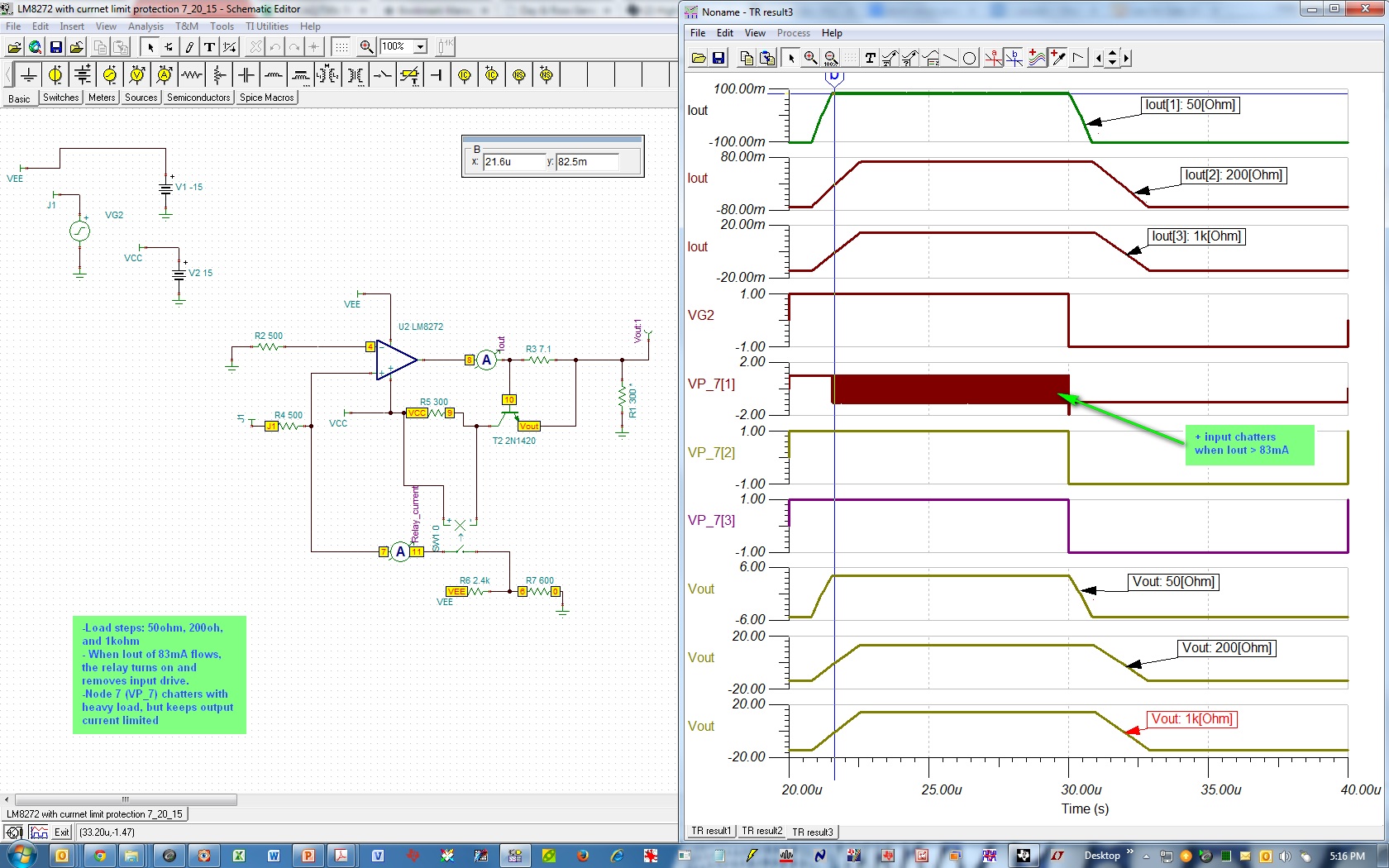

  • Hi Athul,
    For protection against short circuit condition, you may have to devise an external protection, as shown below. This circuit will limit the output current to ~83mA (=0.6V/ 7.1ohm) sourcing. It works by removing the input condition that causes the output current to cause protection transistor (T1) VBE On condition:
    Here is the TINA-TI circuit for your reference:
    LM8272 with currnet limit protection 7_20_15.TSC
