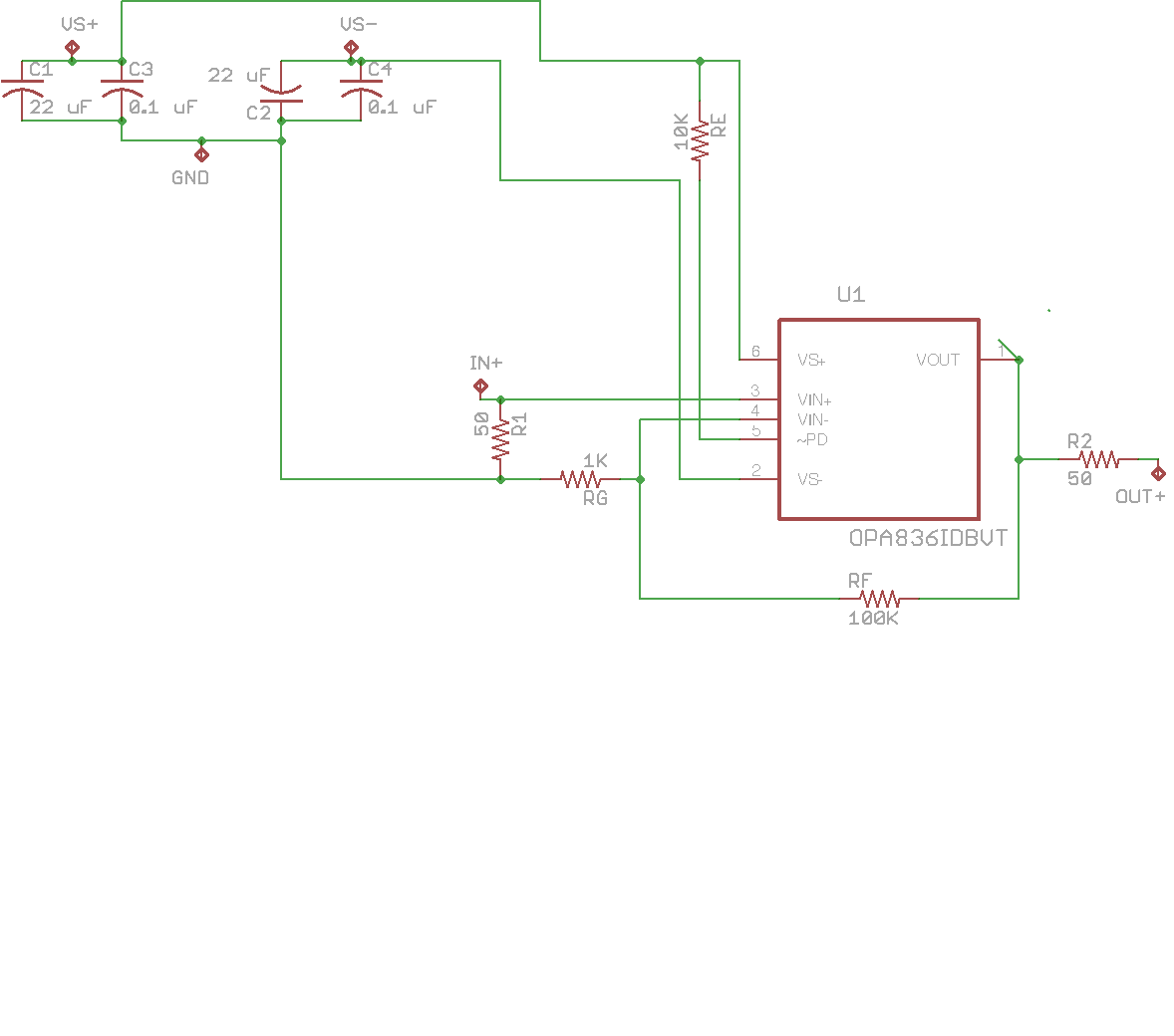

  • Hi Rohit,
    The supply current is about 1 mA when we power it up using V = +/- 0.8 V. The input amplitude is about 10 mVpp and we set the gain to be 100. It doesn't seem to have any jump in the supply current. I attach the schematic circuits on the following, I guess there are two issues,
    1, is the gain too big?
    2, the VS- and the output pin seems to go under the OPA836 itself and it could cause potential capacitive coupling? We are still working on the design of the circuits. Any suggestion?
    John

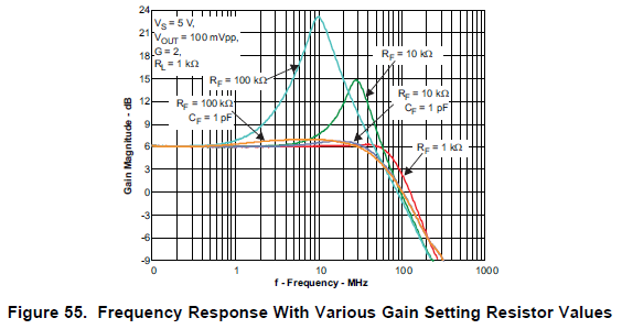

  • Hi John,
    It seems that Rf value being used is too high close to 100k. It is recommended in the datasheet to restrict the value of Rf to 1kohms for gains higher than 1V/V. OPA836 shows significant peaking with Rf ~100kohms just for gain of 2V/V. So, I would expect it to be oscillating at 100V/V gain with Rf ~ 100kohms. Is it possible that you can make Rf = 1kohms and Rg = 10ohms for a gain of 101V/V and try running at +/-1.25V, to see if it does not give high frequency harmonics?
    Rohit
  • Good point. We are searching for some 10 Ohms thin/metal film resistors which has the same temperature coefficients with the 1k Ohms resistor. We can work around that, I think. Those resistors should be made from the same materials such as Nichrome. I'll keep it update once we has process on that.
