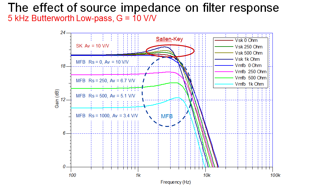

I have a quick question which is intended more as a sanity check.
I am planning to employ DM3725's video DACs to produce a PAL signal on the other side. My intention is to bypass internal buffers and use an external one. Since OPA361 incorporates an internal filter, it seems like a very nice idea to use it. The problem is, its gain is way to high. DM3725's datasheet states that when DACs have 1.5kOhm as their load, the output voltage is 0.7V.
The question is as follows. May I change this load to a different value to adjust the output voltage?
If so, should I include internal 500Ohm that OPA361 has at its input?
What should be the series resistance placed at the input of OPA361? As my calculations suggest, it should be ~1.6kOhm. Is my understanding of this correct?
