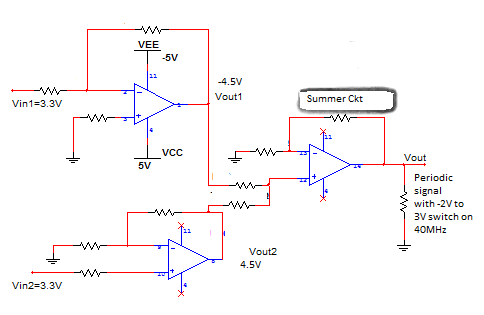

  • Hello Abhi,
    I'm not entirely sure what you are describing in words. I think a schematic or block diagram would be much better, if you can attach it here.
    Hooman
  • Hello Hooman,
    Sorry if I could not made you understand my application. Here, I am attaching the schematic with op-amp still to be decided. It is being utilized with lower frequnency. So I am assuming it should work for the higher frequency as well. Vout of the summer ckt must be -2V low and 3Vhigh with definite 40MHz.
    It would be very kind of you if you could help me out.
    Thank you.
    Abhi

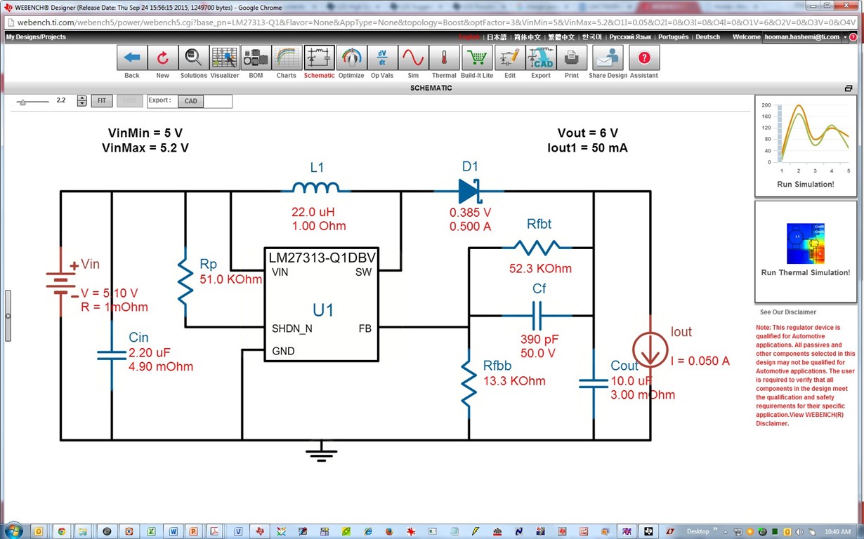

  • Hello Abhi,
    The list of high slew rate op amps that I gave you earlier still stands. One possibility is that if you can raise your +/-5V supply voltages higher, then you'll have more devices to choose from that have high slew rates (e.g. OPA659, and OPA2674 are good examples) because you will eliminate the requirement of having to swing close to the supply rails.
    Here is a design which TI Webench produces when you want to raise your 5V supply to 6V for this purpose with about 50mA output current capability:
    You would need to do something similar for the -5V supply to produce something like a -6V supply instead to run the devices (Webench can probably be used for that design as well).
    Hooman

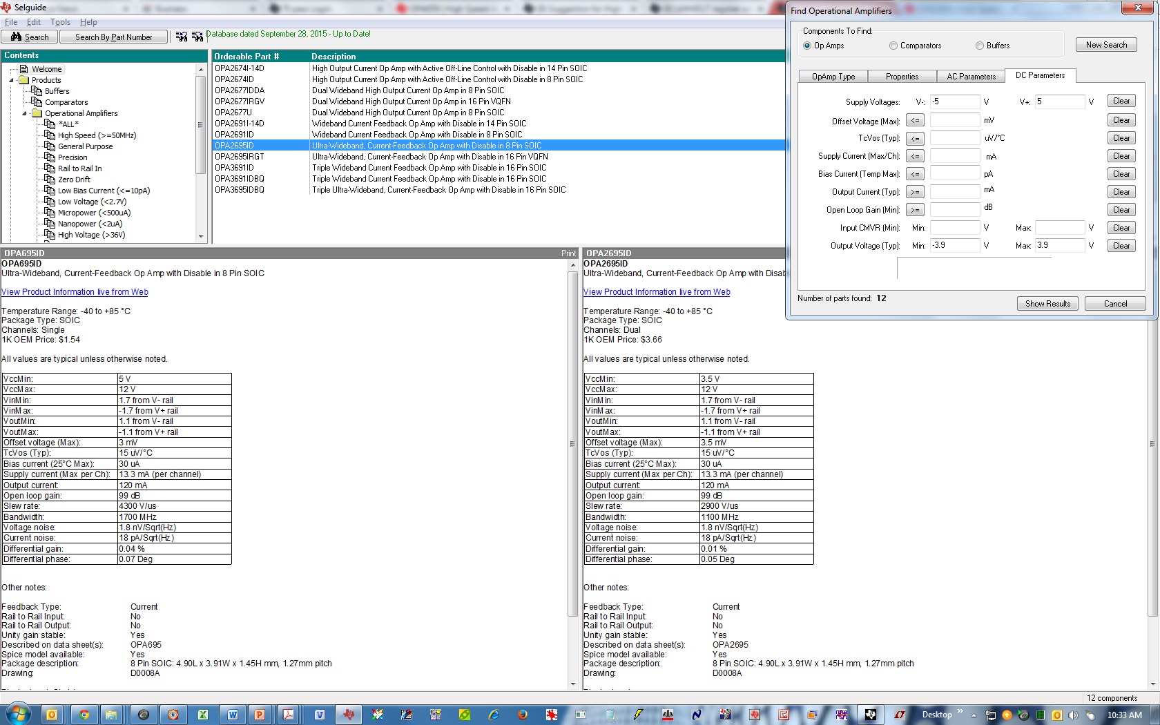

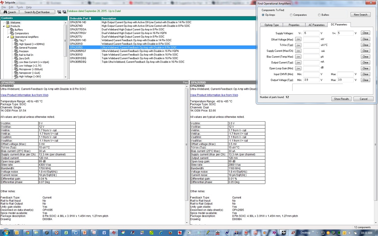

    But, as OPA659 is single channel op amp can you suggest me to multiple channel channel with comparable parameters from TI? As you know I have to implement adder ckt in the final stage, would require more than one op amp.
    Abhi
  • Hi Abhi,
    The OPA2695 (dual) has many of the characteristics of the OPA695, as the Selguide image below shows how they compare:
    Hooman
  • Hi Abhi,
    If you must have a traditional voltage feedback device (OPA2695 is Current Feedback), then I suggest the OPA2690 (dual) or the OPA3690 (triple).

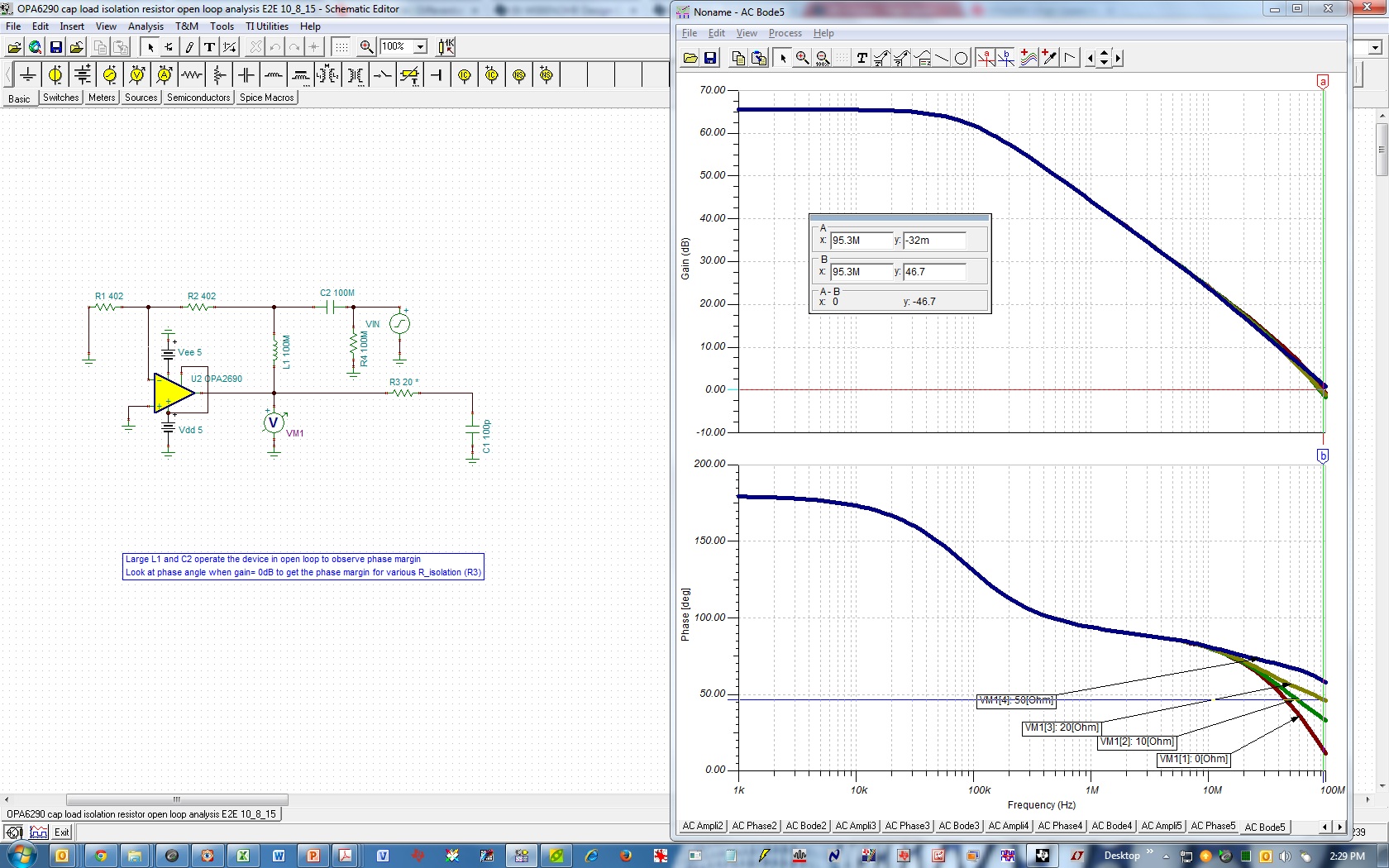

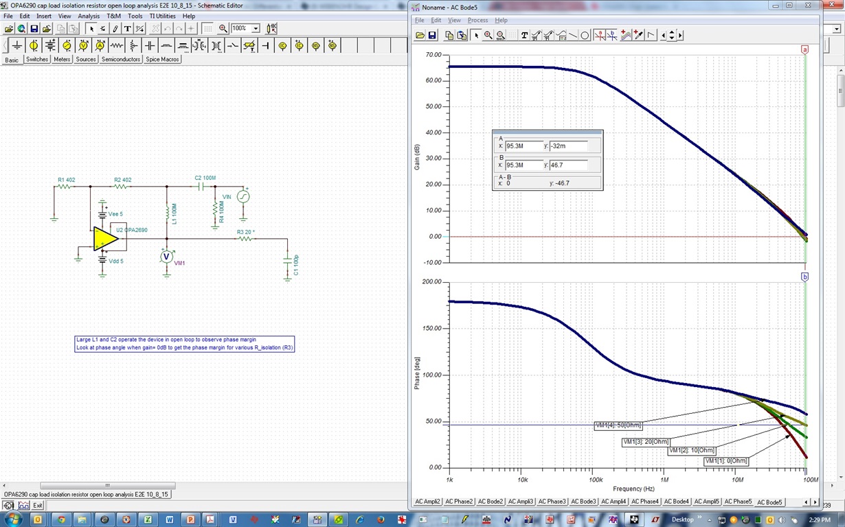

  • Hi Abhi,
    Here is one way to predict the isolation resistor OPA2690 needs for a given cap load using TINA-TI simulation.
    I've used the OPA2690 model in simulation and used a large L and large C to open the loop and look for phase margin.
    For the simulation shown below, I've done the following cases:
    CL= 100pF
    Series Isolation resistor (ohm)        Loop Gain 0dB frequency (MHz)          Phase Margin (deg.)
    0                                                               91.3                                                              15.8
    10                                                             91.4                                                              34.9
    20                                                             95.3                                                              46.7
    50                                                             87.3                                                               60.5
    So, 50ohm or 20ohm are good resistor values to use (based on the simulated phase margin).
    Here is the TINA-TI file for above:
    OPA6290 cap load isolation resistor open loop analysis E2E 10_8_15.TSC
    Hooman
