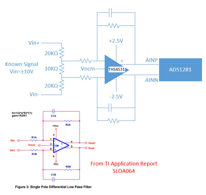

  • I think it is hard to find a low-power FDA with ±10V power supply.
    The input range of differential signal are known.
    if I use a voltage divider and LPF like following. (Vin = ±10V to ±2V)
    Will it work in practice ?
  • Hi Yu-Hung,

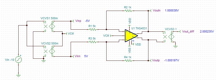

    That may be a possible solution! You could try configuring the FDA to have an inverting gain of 0.2 V/V, like such:
    Here is the TINA file: THS4531.TSC

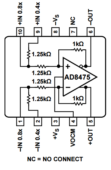

  • You could possibly use the AD8475 funnel amplifier from Analog Devices. The applications section shows a 20Vpp signal converted to 4Vpp with a level shift to 2.5V for example.

  • Hi Steve,
    A. The Quiescent operating current/ch of THS4531 is 330uA(max).
    B. The supply current of AD8475 is 3.2mA(max).
    I have no idea how to compare them to know which one is low-power.
    PS.  The same kind of IC components(eq. ADC) have different spec. description, even in same manufacturer!!!
    This lets me confuse until now. :(
    The interesting thing is the functional block diagram inside AD8475 is similar with Chris's given.
    Especially the reference application is useful.
    Thanks.
    Yu-Hung
  • Hi Yu-Hung,
    The Voltage-Controlled Voltage-Sources (VCVS) are ideal voltage buffer/amplifiers components. They are  used in the simulation to convert the single-ended voltage source into a differential signal, and then later to measure back the differential signal as a single-ended signal.
