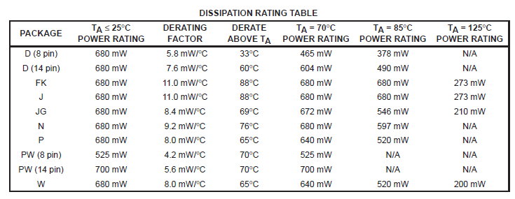

I use TL072CDR for STB application, and found the Tc (case temperature) is 69 °C.
I found only Ta (ambient temperature) spec from datasheet as below.
I wonder the Tc or Tj(can speculate Tc - include θjc) information of this IC.
Please let me know.
if TI cannot share the information, let me know how to measure Ta. (e.g. 1cm from case...)
