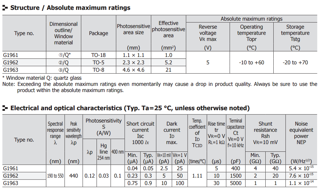

  • Hi Tim,
    Thanks for replying. For now, I will have to stick with G1963 from Hamamatsu. See the picture below for your information. This is the first time I am designing such a sensor so I am a beginner. I want to start from beginning, if you think I need to use a different amplifier please feel free to tell me as i am only using OP320 because it was used in the reference design file.
    So, what would be my goals first of all and how to determine it. I could say I need 1GHz but how to justify it like you said you need > 1MHz for -3dB Bandwidth?
    Saif Malik

  • Hi Saif,
    The bandwidth of the circuit will depend on the frequency of your input signal. The input signal in your case will be a light source for the photo-diode to detect. For example, in the design file a test to verify performance of the design was to use a 500kHz square wave light source generated from another PCB (TIPD108) as the input. That was the input frequency for that test.
    So the bandwidth required for your design is dependent on the rate at which you expect the light source to change. If you expect it to change once every millisecond then you only require 1kHz of bandwidth. If you expect it to change once every 100 microseconds then you only require 10kHz of bandwidth.
    -Tim Claycomb
