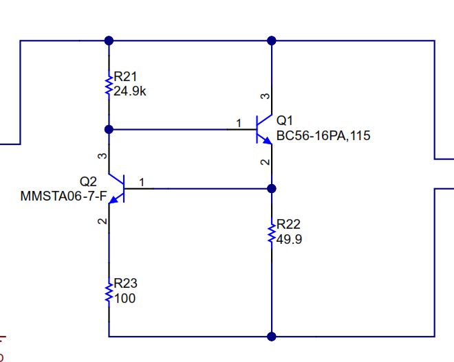

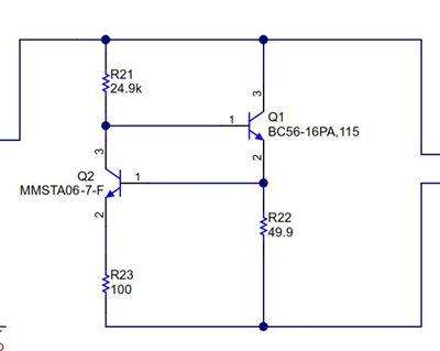

    The most common external current limit is the circuit shown in the image below.  While this particular example wasn't for a 2-wire transmitter, you would connect the loop supply to the top connection and the current limited output to the bottom.  In normal operation the Q1 transistor is biased by R21 and is active allowing current to flow from the loop-supply to the transmitter through Q1 and R22.  When the voltage drop across R22 is high enough (~0.6V) the Q2 transistor becomes active and steals the base current from Q1, limiting the current that can flow through Q1.  Therefore the current limit is set using the equation below:
    I_limit = Q2_Vbe / R22.  So in this example the current limit is roughly 0.6V/49.9Ohms = 12mA.
    As mentioned above the trouble with this type of circuit is that the Vbe voltage will vary from BJT to BJT and the Vbe voltage changes over temperature at roughly -2.2mV/C.  The R22 resistor will also have a tolerance and will also change value over temperature based on its temperature coefficient.  Therefore this circuit is typically used to set a current limit between 27 - 30mA which prevents it from becoming active and affecting the accuracy at the 20mA full-scale output level.

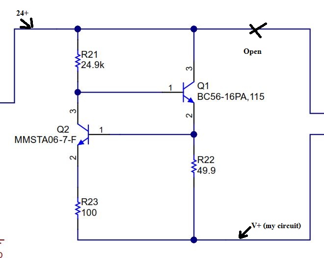

  • Information form my customer , They use ABB PLC, AI801 Analog Input Module ,0(4)..20mA . From your advise circuit ,I could be put it as picture. below
    Please advise, Thank so much.

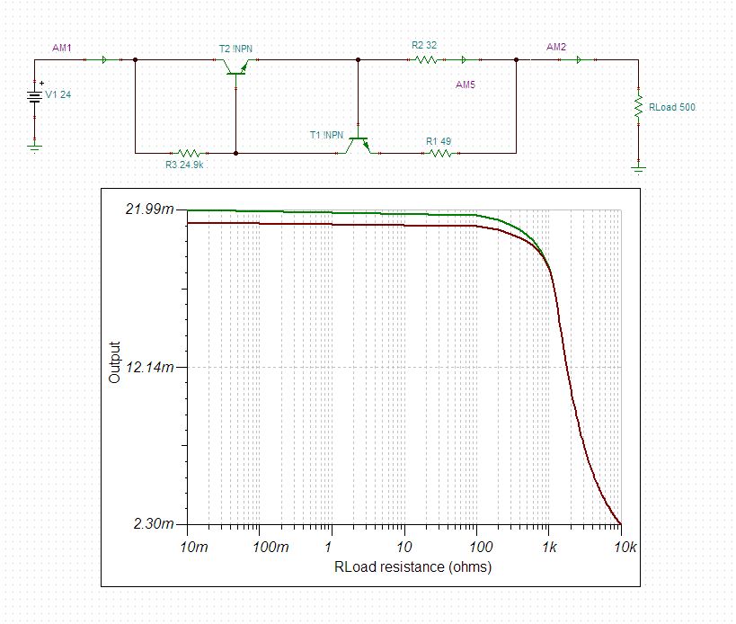

    Yes, you're correct.  Attached is a TINA schematic that you can use to test the behavior of the circuit.  I configured it for a 22mA current limit.  I'd like to state again that setting the current limit 2mA away from the 20mA full-scale level will likely introduce errors over temperature and product variation as the current limit will affect the 20mA output levels.

    Here's an image of the circuit and results.  Notice that as the load current continues to decrease the output current is limited to 22mA.  Also notice that the knee of the curve includes 20mA which is why I mentioned that such a low current limit will likely affect the 20mA output level.  The TINA file is attached below it so you and the customer can test the circuit operation.
    Simplified_Current_Limit.TSC
