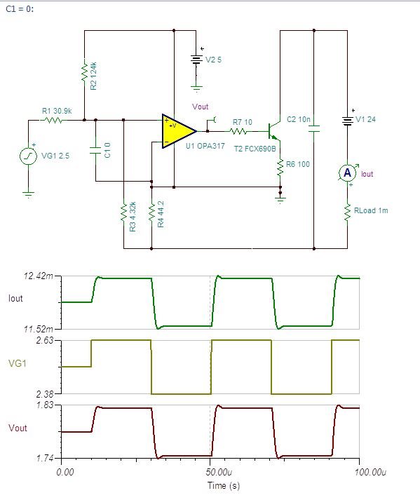

  • The design featured a 10nF capacitor between the Iin and IRET pins of the XTR115.  Placing a capacitor at this location causes stability issues in the XTR products (and any other op amp circuit) .  If you look at the XTR115 datasheet you'll notice that the IRET pin is the inverting input of the op amp internal to the XTR115.  Connecting a capacitor between the non-inverting input and the inverting input of an op amp is an easy way to cause op amp circuit stability issues.
    To properly filter the inputs of the XTR115, XTR116, XTR117 or other 2-wire 4-20mA integrated circuit solutions, divide the input resistor into two parts and place the capacitor to GND (IRET) at the node between the two resistors.  This way the filter capacitor is isolated from the non-inverting input which will prevent the negative interactions with the feedback network.  While we don't have a complete SPICE model for the XTR115 the cause and effects of placing a capacitor at this location can be understood using the attached TINA schematics for a discrete 2-wire 4-20mA transmitter using the OPA317. To see an example of this effect look at the results below.  The final circuit shows the 30.9kOhm input resistor divided into two parts and the filtering capacitor is placed at the node between the two resistors.
