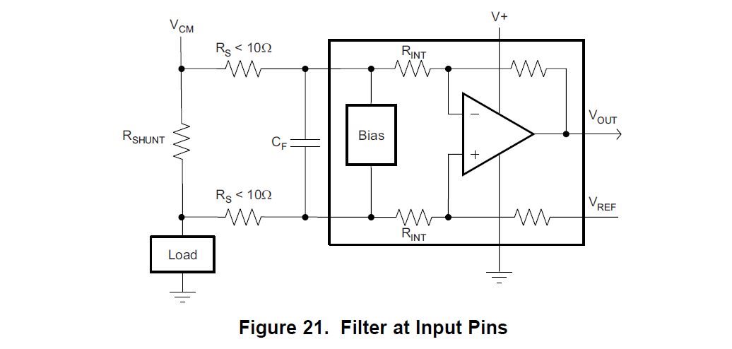

I'm considering using an INA199A1 (gain of 50) as a high-side current monitor.  My shunt resistor voltage drop is only about 6 mV, but accuracy requirements are not high.  CM voltage is 5 V.
I've looked through the app notes and training videos, which make the contribution of Vos to output error quite clear.  I don't see any treatment of Ios errors though.  The INA199A1 specs a max Vos of 150 uV, which would lead to an output error of 7.5 mV.  Typical is much less.  The typical Ios, however, is .02 uA, which leads to an output error of 20.0 mV through the 1 M feedback resistors in the device.  No maximum is given.
Can this be correct?  It looks like the Ios typical error is much greater than the Vos maximum error.  Please let me know if I'm misinterpreting this somehow.

    I don't understand why the Ios doesn't affect the output as I mentioned, though. If the input were shorted (zero volts) and the internal opamp had .02 uA offset current (with no other errors), the output would have to go to .02 uA * 1 Mohm = 20 mV to compensate. Please help me understand why that doesn't apply.

    The input stage of a current sense amplifier is biased by the inputs.  This input bias currents do not flow through the feedback resistors.   Figure 21 in the INA199 illustrates the bias circuitry and is seen below.  This is the reason that internal the IOS do not contribute a high error unless you add filter resistors as described in the data sheet in the INPUT FILTERING section.

    Does the opamp in the figure represent an ideal one, with no error currents? In that case I can see where error currents from the Bias block would pass almost exclusively through Rshunt and have little effect on the output. In other words, the error currents in the data sheet refer to the entire INA199 and not to the internal opamp.
  • Gerrit,
    Yes the IB and IOS in the datasheet do refer to the entire inputs and not to the internal opamp. Please keep in mind that this IB and IOS is at one point with Vsense = 0V with VCM or Vin+ = 12V. Even though IB and IOS change with Vsense and VCM change the biggest errors due from these IB changes is if a input filter resistors are added.
