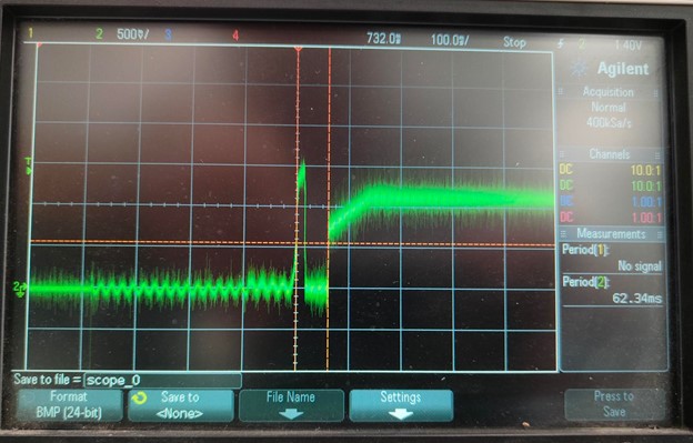

    I have finally developed the final version of the board. This consists on a single reference chip (MAX6185), the OPA2227 used to buffer the reference. The output of the buffer goes to the 16 reference pins of the ADCs (ADS7229). Every ADC reference pin has a 22.1uF capacitor next to it. The opamp has been compensated to capacitive loads following the post.
    Unfortunately, I see the following:
    - the OPA2227 heats up to 47degrees
    - If I look with an oscilloscope at the output of the buffer I dont see oscillations until the ADC input value (VIN_ADC) reaches +10V (for +11V there is no oscillation)
    - If I slightly vary the input voltage (example: from 9.999 to 10) the oscillation does not occurs
    - If I touch the compensation network the oscillation stops and appears again if I vary the voltage to +10V
    - The oscillation appears only when the ADCs are converting. If I stop the conversion, the oscillation does not occur in any case.
    - If I let only 2 ADCs convert, the oscillation does not occur.
    Since there is no oscillation when the ADC are not converting, I assumed that the OPAMP was properly compensated. I also tried to decrease the capacitive load from (22.1uF x 16) to (10.1uF x 16) and the behaviour was exactly the same. Therefore I would say that the oscillation is caused by the sampling of the ADC which introduces additional stress into the OPAMP.Additionally, what I cannot explain is why this happens only to a specific input value.
